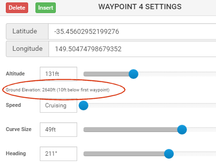

    One of the best features of mission hub to plan the flight is the elevation information it provides for terrain anywhere in the country. This helps you understand what elevations you need to adapt to. Priceless when planning for the outback.

  14. Suhail78
    Aug 15, 2016
    435
    147
    This is ground elevation from sea level right? Sorry, this is a dumb question, but How do you make the most of this information while planning missions?
  15. Kamloops
    Aug 9, 2016
    55
    30
    Buddy is 100% right on this one! Review and re-review these elevations and you will be fine. Ignore them and plan on getting to know the UPS guy real good for all the parts you will ordering.
