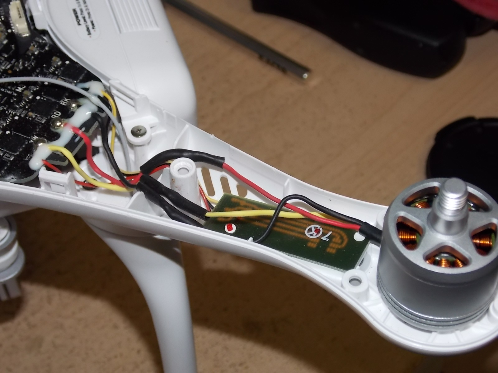

Any ideas what's going on? I have the latest firmware.

I just got a new controller today and tried out my phantom, it did a little flip and I have not yet.Could be a bad motor. You have not replaced it, have you?
OWE!!! THAT MAKES SENSE!!!!!! THANK YOU WILL TRY THAT TOMORROW!!You might check the screws on the prop guard mount for that leg, I think some folks have had issues with them extending into the motor, locking it down.
Well find out tomorrow but I think the motor is gone.If he ran the Long screws into the motor isn't it damaged anyway?
Makes sense. I do that when my car gets a flat.The motor still did not work so I gave up and ordered a new phantom 3 standard.
You do that too, huh?Makes sense. I do that when my car gets a flat.
Not true. Scrape the coating off the wires and splice away.The tinned leads coming from the motors are actually a continuation of the enameled windings, each strand insulated. They will not take solder properly, or any kind of splice. You will need to remove the silicone sealer at the main board and solder directly to there. Mind your colors.
Have fun!
I have not luck one of my front motors are death i ready change for a new one but still not working
