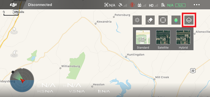

Can someone tell me why I'm getting a yellow screen with the maps instead of being able to see street names or terrain?
Yeah thanks for reply , it looks like I’m in a geo zone that must have been widened .You should be able to switch to the Satellite or Hybrid view by tapping this icon:
