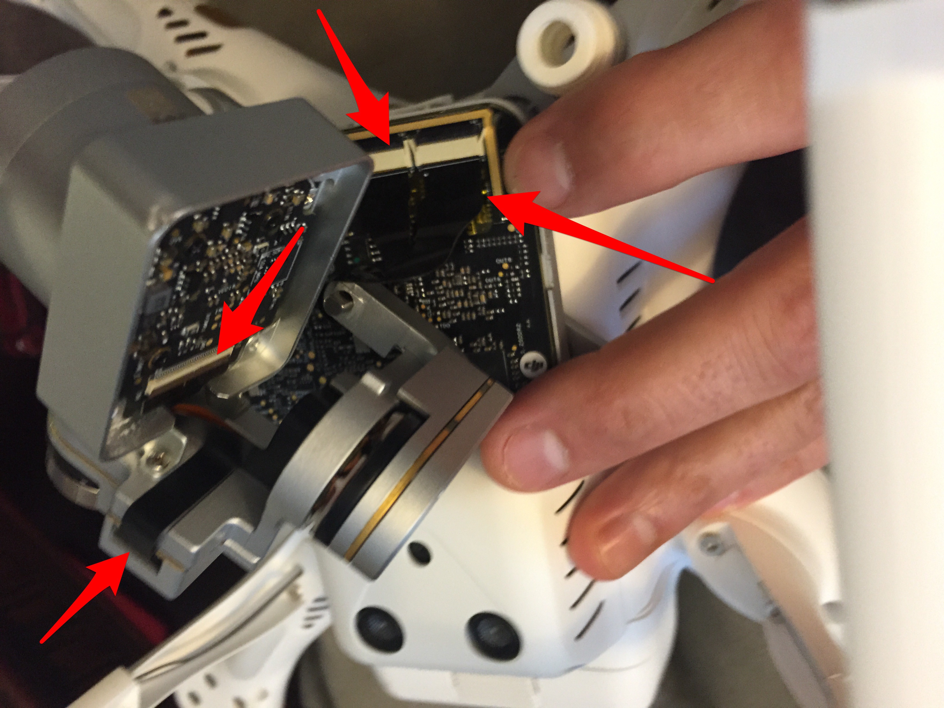

    I just solved this issue on mine. My problem was the connectors labeled in the attached pictures. I had to really really push hard on them. I was having the exact same symptoms as you. Be sure the white lines are NEARLY flush with the connectors. image.jpg

    Ok I follow you now. You weren't talking about the app, you were meaning the firmware. Yes I'm at 1.2.8 as I have the advanced and you have the pro. You messed me up when you said 1.20 of the app. I think you meant to say up above that you had 1.2.0 of the firmware and not the app. Anyway, I think I need to take a look at my gimbal as referenced in the above picture. Can't do that up here, all my small tools I are back in the office, so I will wait until I get back and maybe look at it Sunday night after we get back and the truck unloaded and the dogs settled down from missing us. I will let all know as soon as I check the ribbon cable on the gimbal referenced above and if that is the fix. Thanks all.

    This looks like the thing to check for me. I am real familiar with those ribbon cables. I work on laptops as well as desktop systems. My first time taking apart a Phantom, I worked with them and already had wished they used a lock on them like the "flip over" type locks they use in the laptops. It would keep them held good as these drones to setup a higher frequency resonance which tend to loosen things up over time. Referencing back to Nikola Tesla and his frequency resonance, you can break anything with the right frequency! I am on my way back to Iowa and I'm going to take a look at that right away. Thanks
