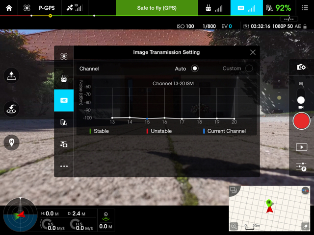

    Dear all, since we did our update on our P3P to FW Version 1.4 and DJI Go 2.2 we have big troubles with our live preview on our Ipad Air IOS8.3. we loose every 10-20 sec. the live signal for also 20-40 sec . I am sure the problems come since we did the update, because we didnt touch anything else and before the update everything was fine. There is no difference if the P3P is only 1 meter away from us or 200 meter. Also no difference if we are in the air or the p3p is still on the ground.
    Anyone else having thistroubles? Attached a pic with the channesl, which are still on a low level i guess.
    Any tipps from you?
    Ciao
    Werner ImageUploadedByPhantomPilots - DJI Phantom Forum1442172772.109338.jpg

    What exactly were you trying to show in the pic? The channel graph flat lined?
