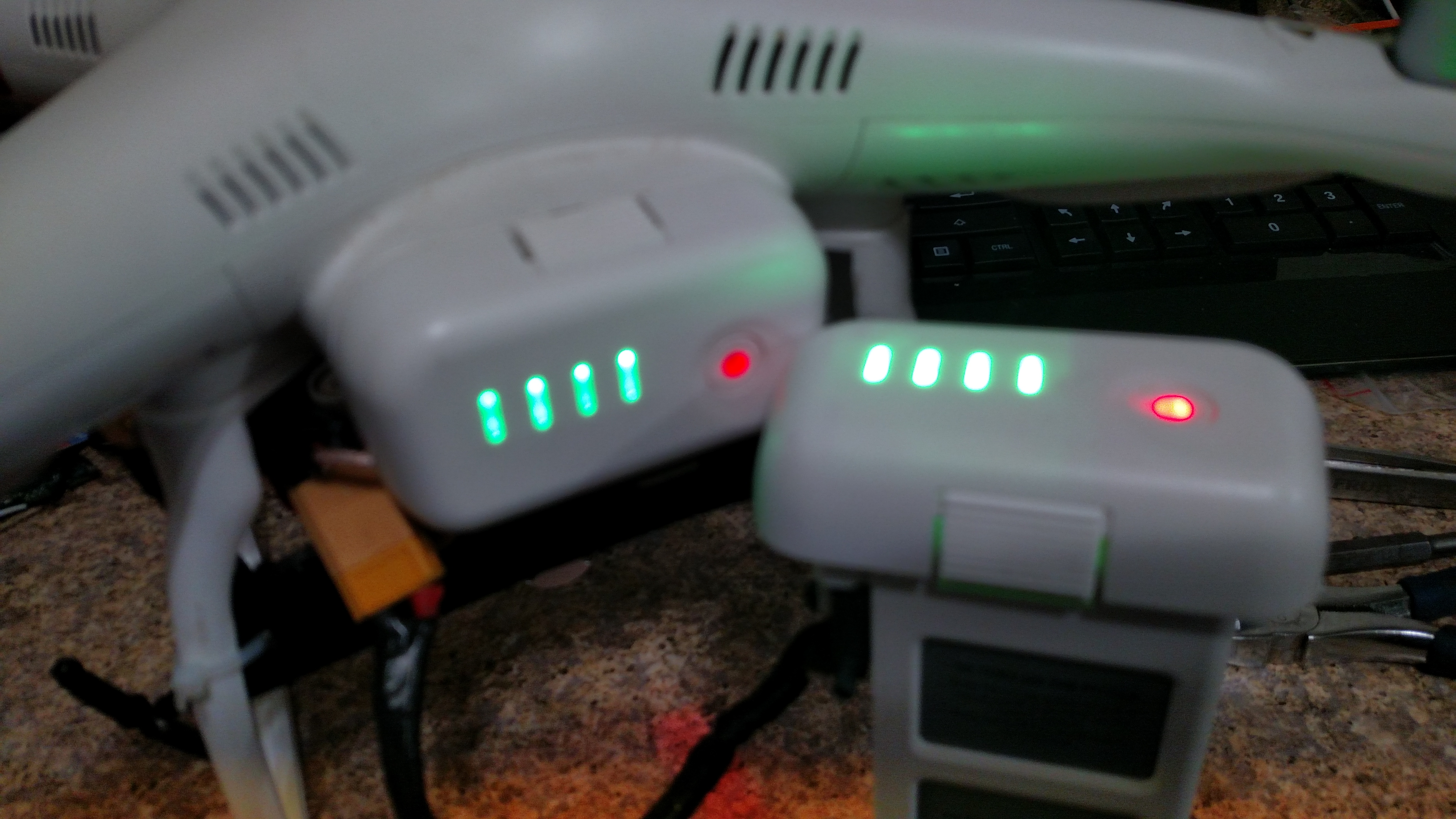

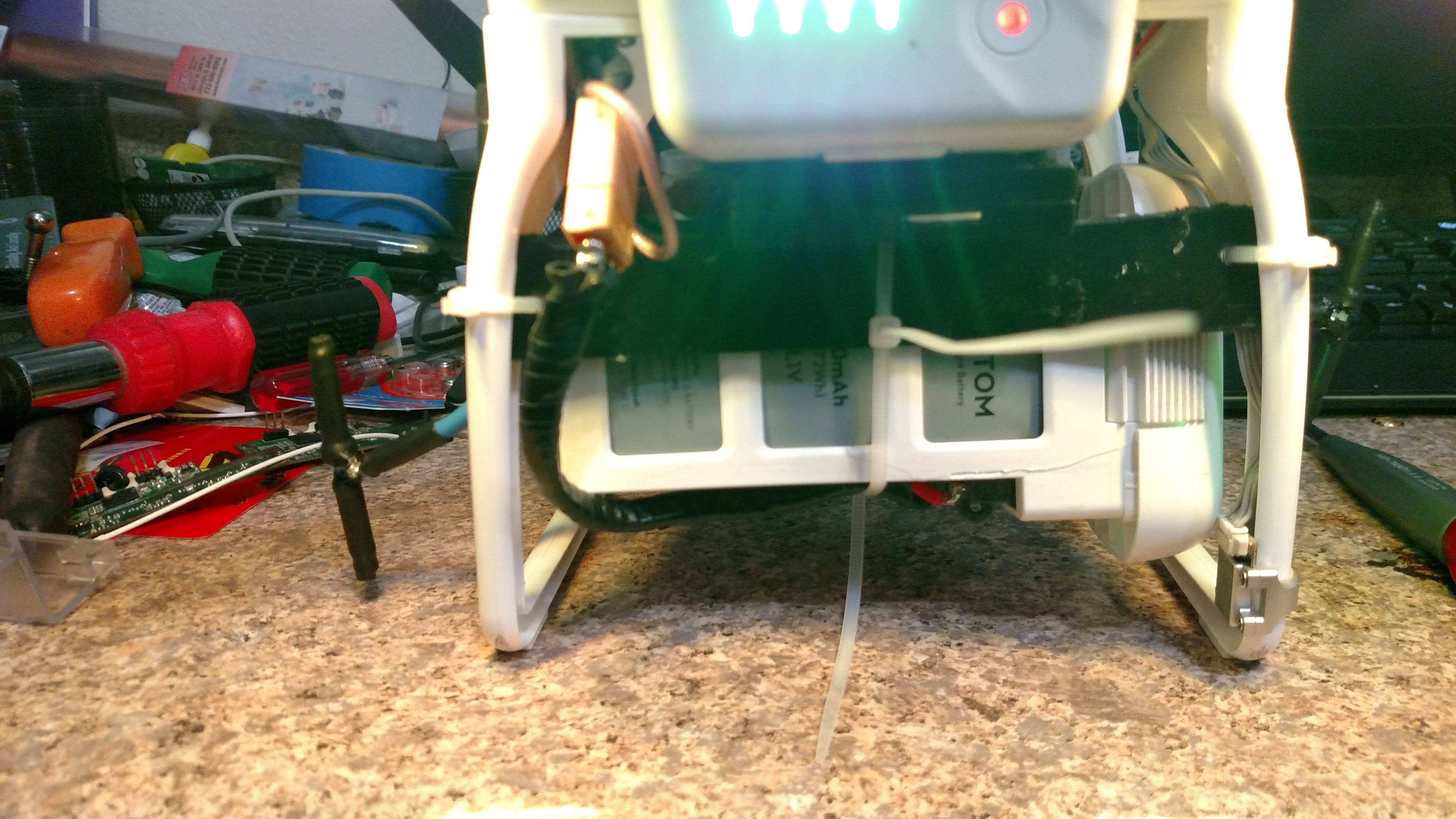

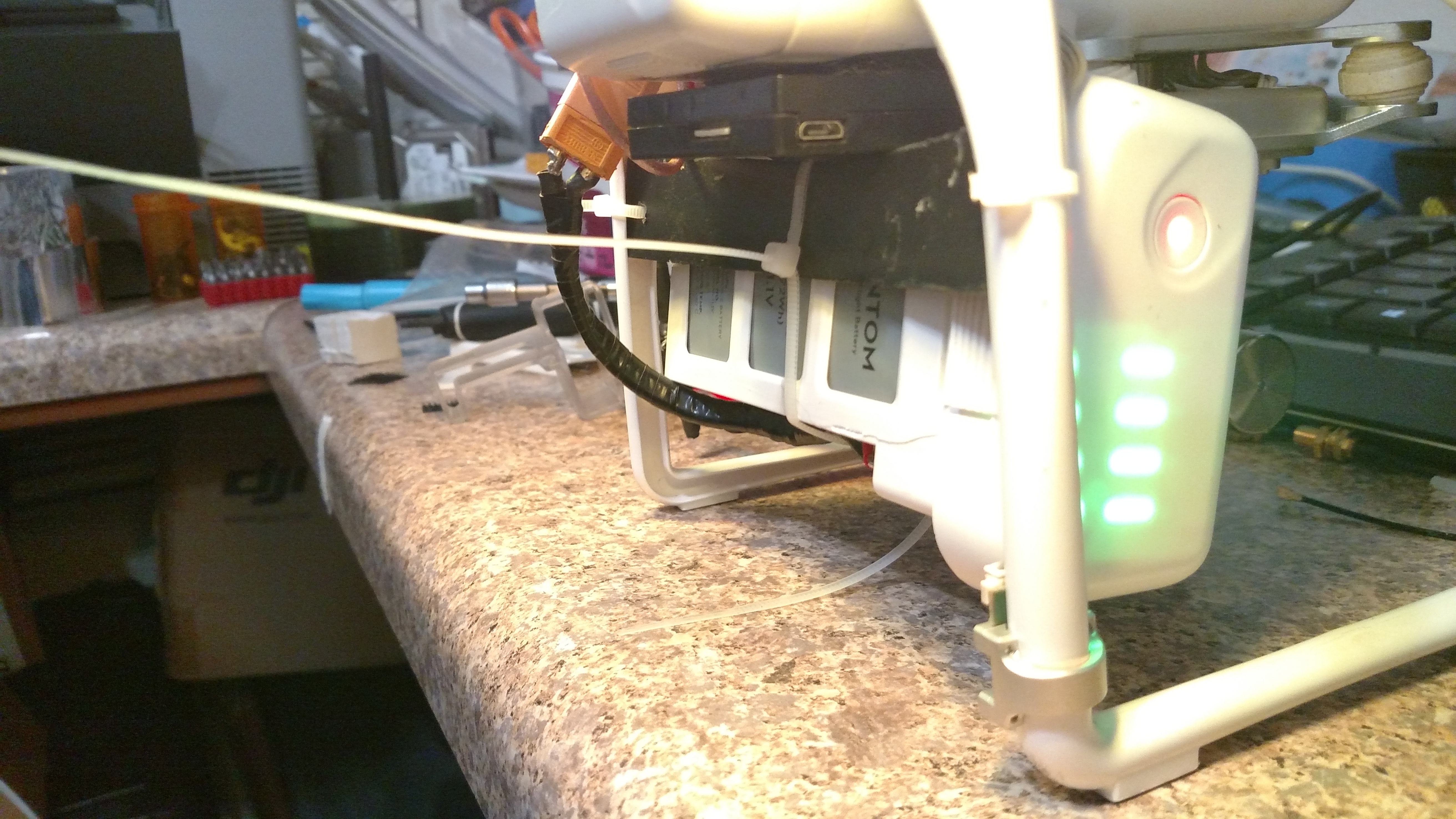

I had a part left over from and old P2, the plug that goes into the battery. (picture 1). So I adapted it to a xt60 plug. So I can use two smart batteries.
I was going to try and use one of the after market batteries and it would not work with the DJI smart battery. I had the after market setup as the main battery and the DJI as the extra. when I would start up the main all is good and then start the extra battery the main would start binging like it's charging. and if I turn off the extra battery the main would go off also. So I switched out to 2 DJI and it work perfect.
today with both 5200 batteries on. I flow for about 15 3/4 minutes a lot of stop and goes and landed with 39% battery. Funny thing is when I turned off the extra battery (first) the it turned off the main battery too. The main battery had two solid green lights still and the extra had two solid and 1 binging light. I could see that the drone was recalculating flight time.
With the extra weight it did not seem to bother the drone. left and controls were good. weather was 73 degree and humidity was 70%. with a little wind maybe 3 mph.
