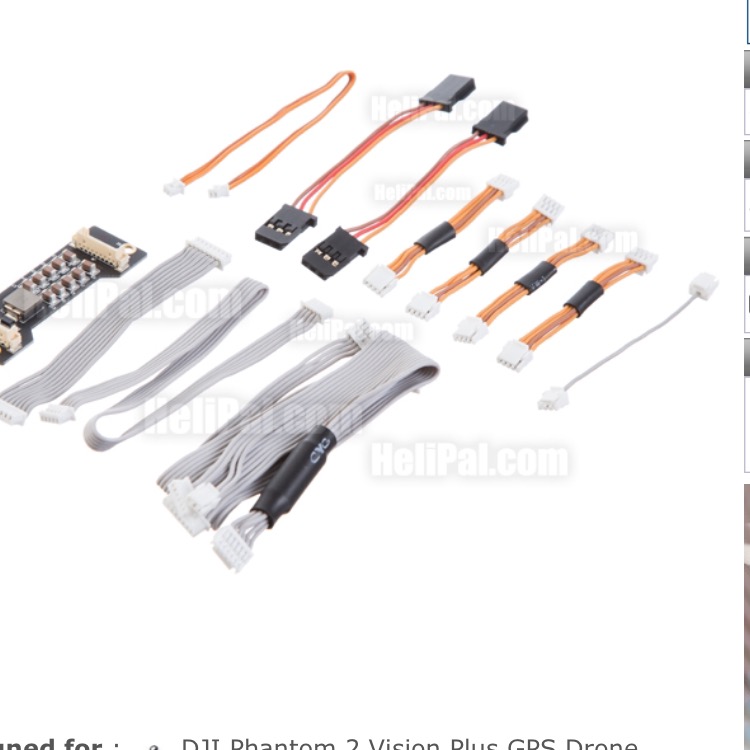

  3. volt5015
    Apr 16, 2015
    24
    I'm also looking for a cable that connects to the wifi module. I had a crash and had to replace the module and now the cable (damaged in crash). I am trying to avoid buying the whole cable package $30. Anyone have the small gray single wire in the attached pic?
  4. Mark The Droner
    Aug 26, 2015
    4,431
    1,359
    It could be the transmitter is fried since it was probably trying to transmit with a broken cable. What I mean is, one of the two transmitters may no longer transmit.
    Regarding the cable, you want something like this: IPEX UFL Female to Female Coaxial Cable 1.37mm OD 15CM
    However, since you're already in there, this is an opportunity to mod your bird and mount an antenna outside.
    Good luck.
