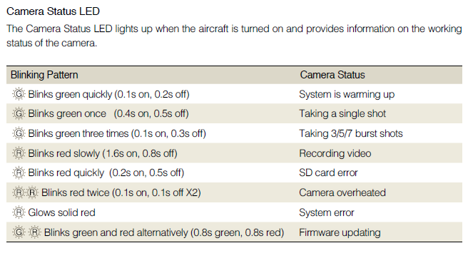

E Edward McCarter Joined Jul 1, 2016 Messages 4 Reaction score 0 Age 70 Jul 21, 2016 #1 There is a little red light that flashes on the front of the camera gimbal. Is that just a power indicator or should I be concerned. It is a P3S.

Techcop50 Joined Sep 25, 2015 Messages 1,095 Reaction score 346 Age 70 Location Aiken, SC, USA Jul 21, 2016 #2 I believe you are referring to the "Record" indicator...
msinger Approved Vendor Joined Oct 30, 2014 Messages 31,960 Reaction score 10,786 Location Harrisburg, PA (US) Website phantomhelp.com Jul 21, 2016 #3 Here are the camera status LED blink patterns from the Phantom manual:
