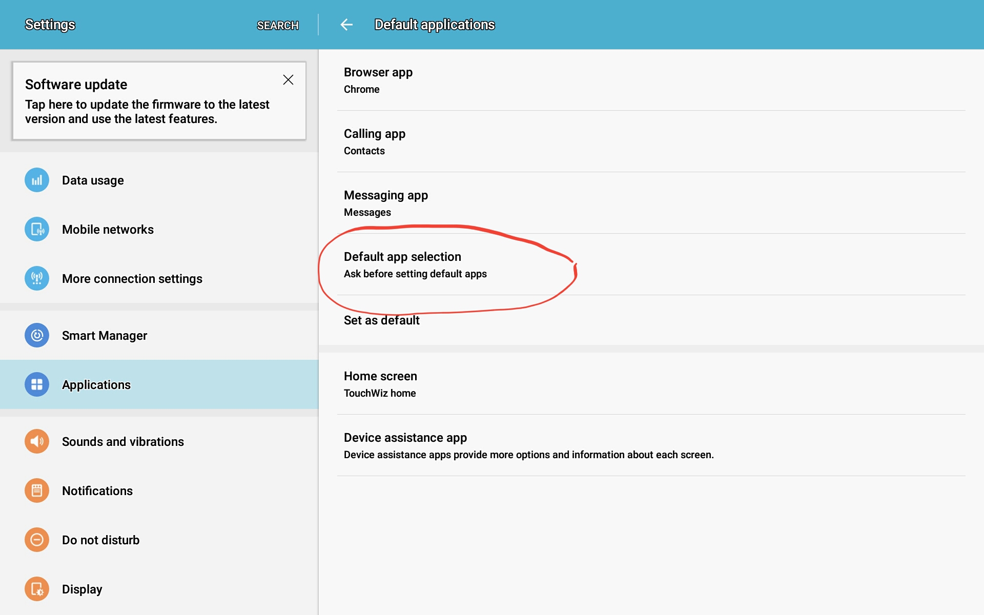

HI I'm samung tab A,, I have mine set here
HI I'm samung tab A,, I have mine set here View attachment 101731
Thanks IAN, I have that set that way also. As I found out after much anguish and research, the latest version (SM-T713) of the Tab S2 has a problem with the USB connection to DJI GO, and Litchi. I'm able (with the help of forum folks) to work around the problem. I am certain SamDung is not going to fix the problem.
