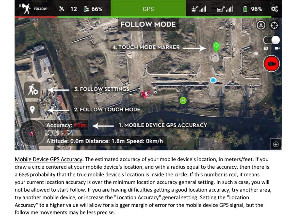

It's the gps accuracy needed on your device/tablet, not the phantom.
Yes, the device needs a good gps lock.I'm a little confused. Are you saying that my mobile device needs to have gps capability? Or do I just need to draw a circle of where I am on the map? New to Litchi.
Galaxy Tab 4 has GPS, that's what I use.Hmmm, I'm using a Samsung Galaxy Tab 4 with my RC (no GPS). So, if I want to use "Follow me", I would have to get Litchi Leash so I can use my cell phone with GPS to be able to use "Follow me". Would that be correct?
You should have a blue dot on your map screen representing the tablets location.
