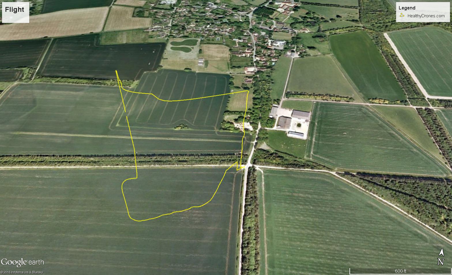

    Interesting.. I had a similar problem with litchi and my p4 also went up and up to 400 metres. I discovered that the problem seemed to be a gimbal protector I had installed which was affecting the sonar and fooling it into thinking it was about to hit the ground and thus increasing power. Do you happen to have one fitted? Below is a track of my problem flight mapped to google earth.

    Thanks for that response. As said this is very similar to my problem except that I managed to eventually activate RTH and it landed. I appreciate that you did not have agimbal guard attached but once I removed mine I have had no further problems. I will be interested to see if anyone else can come up with some suggestions as it seems you had two problems. 1) the climb to a great height and 2) the flipping
