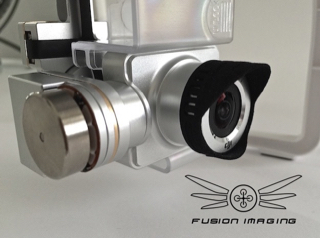

    Some use ND filters or a sun hood to block out the unwanted noise (prop shadow)..

    Sun hood ? How does that work ?

    It shades the lens.
    Prop shadows can occur when flying into the sun, and the shadows fall on the lens that isn't otherwise shaded.
    You can reduce the effect by flying at a different time of day (when the sun is not above your props casting a shadow on the lens), not flying into the sun (fly backwards later reversing the footage might change the attack angle of your props enough to avoiding the shadow falling on the lens, use a ND filter, which will slow down your shutter speed, resulting in a less noticeable shadow, use a lens hood to shade your lens, or perhaps raise your elevation and drop the angle of the camera, and/or fly slower so the props are not leaning hard over the camera.
