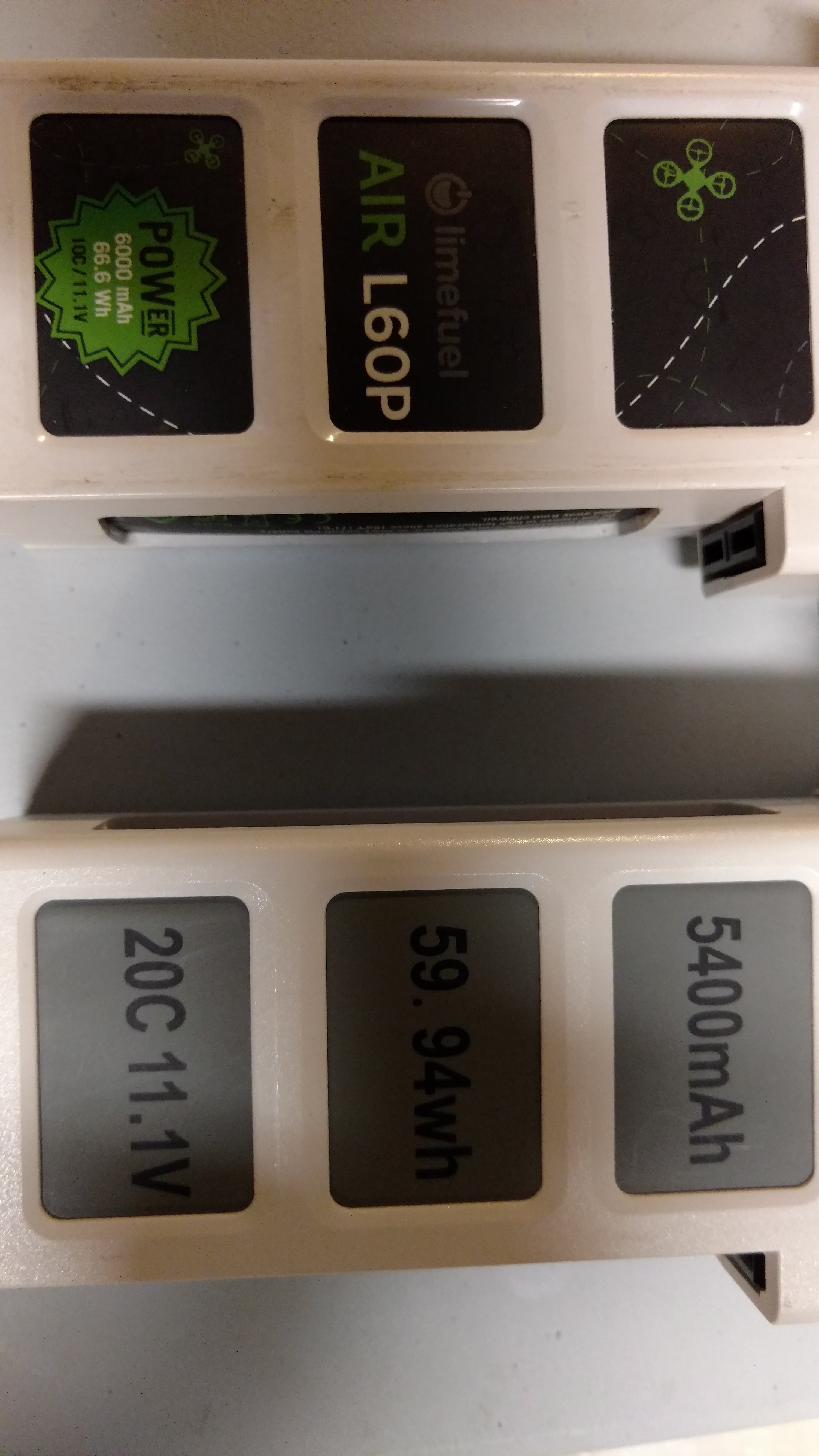

    I just got my new 5400 "Limefuel" battery from amazon.
    except it is not!
    I have 2, LP6000 I got direct from Limefuel and this is definitely not the same labeling.
    good news is it fires up in both my P2V1 with 3.08 and my plus with 3.12.
    It also shows as 6200 .
    Have no idea who the real mfg. is but I will test this out in my p2v1 for a bit first. Screenshot (3).png Screenshot (4).png Screenshot (5).png

    Can we see the ebay link that the battery came from? I got my new limefuel 6000mah today, bought thru Amazon fulfilled by Limefuel. Tested in my P2v+V3 and worked with no problems.
