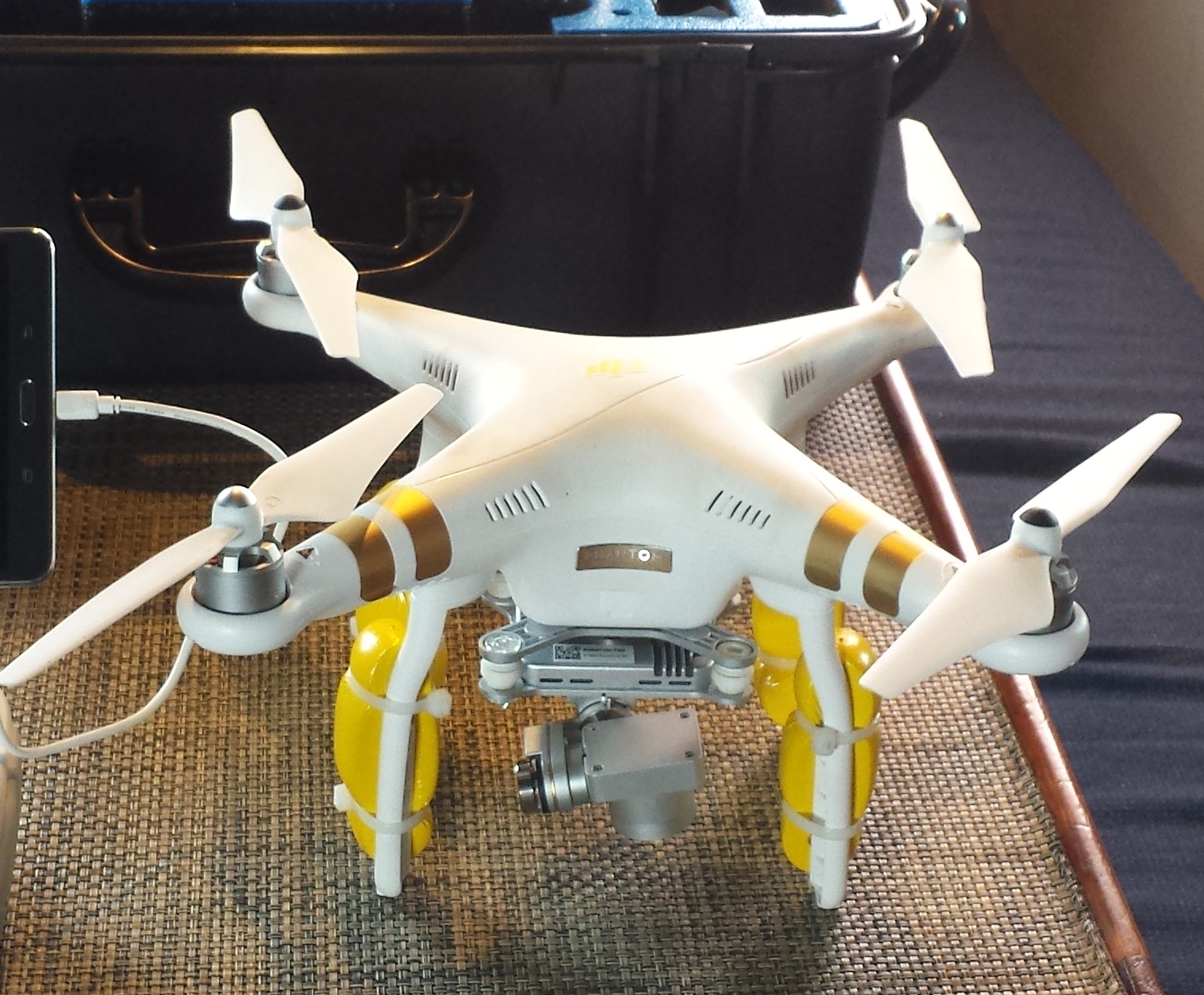

    4. Floats... Add something to help it float in case it ends up in the water. In the case of the person I mentioned having an oopsie under #2, he got the drone back even though it was in salt water thanks to floats... rinsed in fresh water, battery was toast, but the drone dried out and has been totally fine (he says). I would fly with 4 keychain floats zip-tied to the drone legs. Here is a picture... The floats had no discernible effect on performance and could not be seen in the images/video it took

    8. That's about it... I was a bit of a nervous wreck my first few flights from a moving boat but it wasn't as bad as I thought it might be. Good luck. IMG-20150716-WA0000m.jpg
