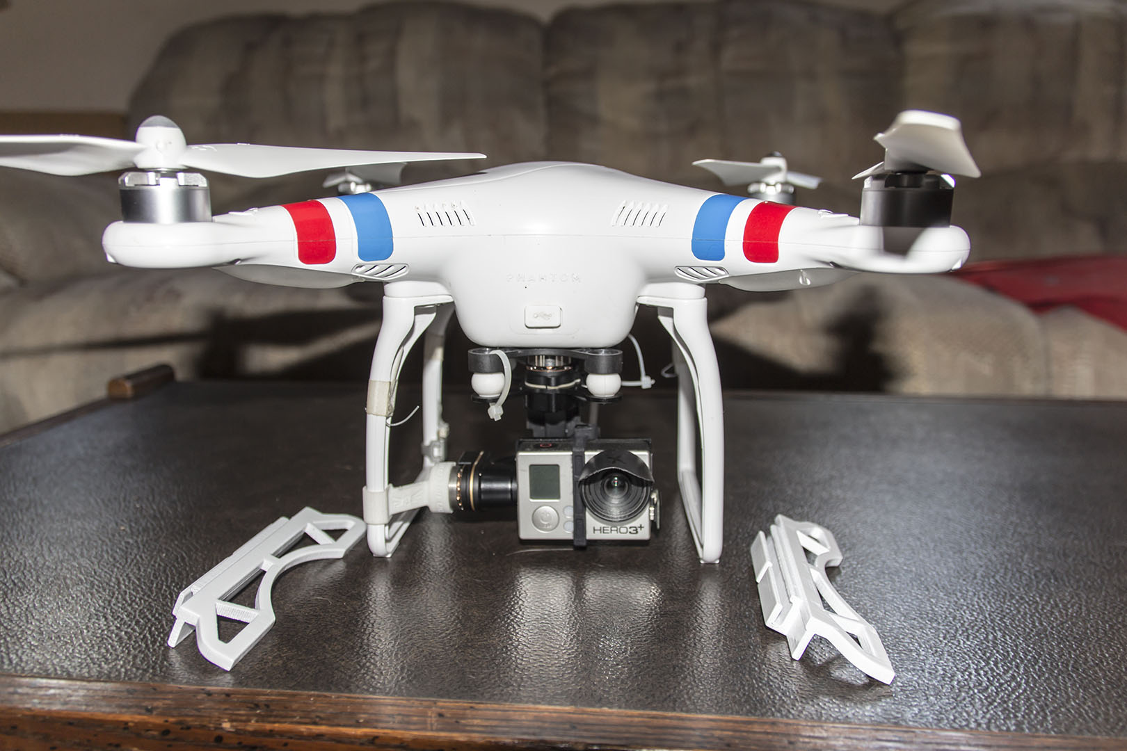

    What GoPro camera are you using?
    Also which format are you using 4K. 2.7K or 1080P??
    Which settings are you using ultra wide or medium?

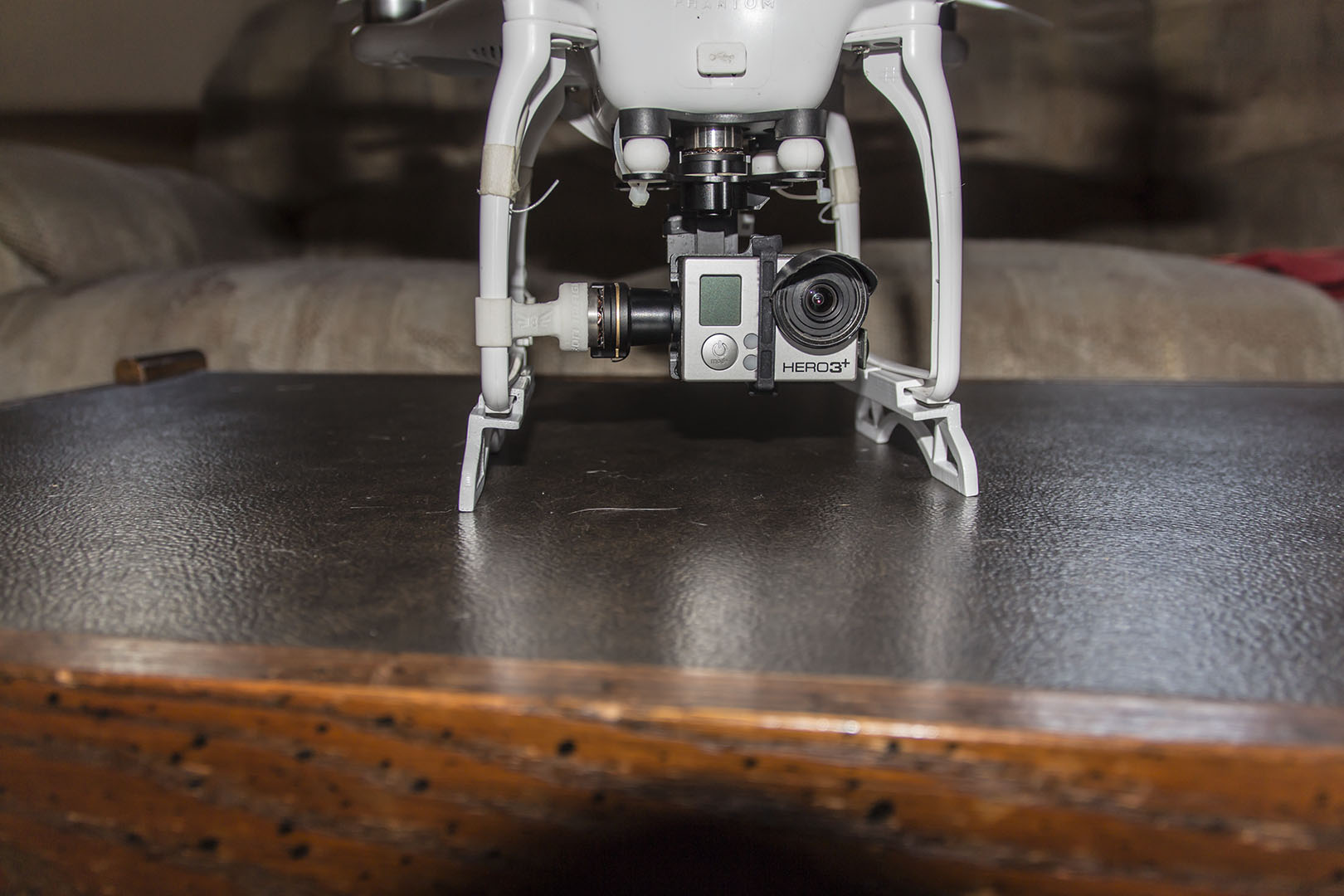

    Since using the newer gimbal the camera is less than a quarter inch off the ground so you need to either buy the longer landing gear or get snap on extensions. All it takes is one hard landing and you'll damage the gimbal, camera or both. So for around 15 dollars you can save a bundle of cash in repairs.

    Im using hero 3+ black recording in 2.7k wide/medium and 1080 superview/wide. I would really like for the landing gear to just be out of the way without worrying which mode i record in and im still deciding how i am going to get this thing higher off the ground since the compass is in the way of removal

    There's only one way to solve that problem and it's to spend 140 dollars and change the lens to a 5.4mm 10mp f/2.8 from
    peauproductions.com. You'll no more landing gear nor props to crop out of your footage ever again. Of course no more choices of ultra wide medium, narrow or fisheye just nice clean video.
