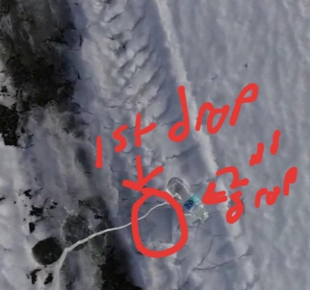

Phantom 4 Pro flying Drone Harmony pre-programmed waypoint and dropping down to 5 ft. to drop off 2 different payloads (1st is a styrofoam box containing 3 golf balls), (2nd is a 16 oz water bottle). Utilizing drop hook system to release payload once it touches the ground. Flew two test missions - 1st was a 1,500 ft loop - 2nd was a 1.1 mile loop (video just shows end result). Both fully automated pre-programmed flight drops landed within 1-2 inches from each other - wind was gusting btwn 15-20mph.
