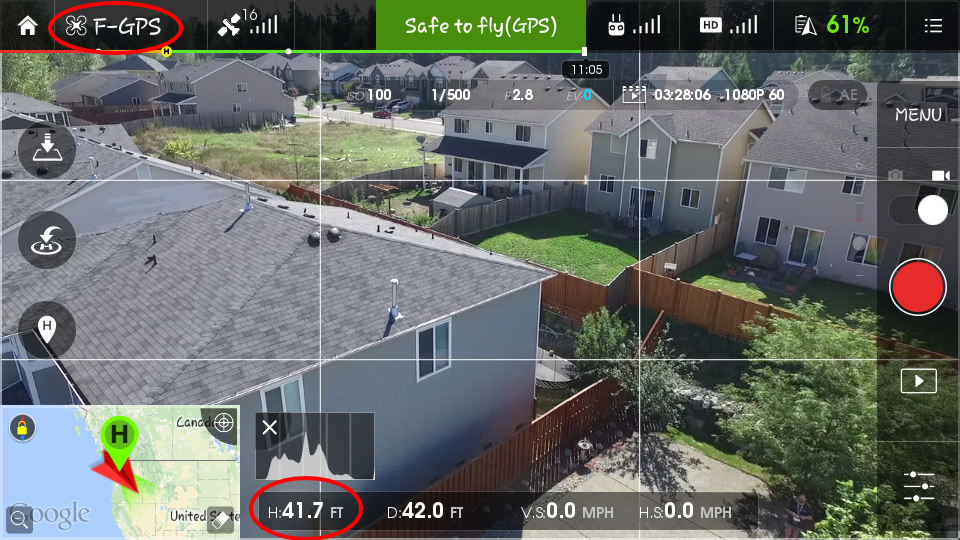

    I've searched the threads for anything related to the issue I'm having, which is the new features aren't showing-up in the DJI Go app. The blue box has yet to make an appearance since I've downloaded the new firmware.
    Before you all chew me a new one for this, just know that I've jumped through all the hoops to try and fix this myself before making this post -
    • uninstall, and re-install the app - no changes
    • download the app onto the root file of the micro sd card, did it with usb 3.0 and 2.0 - no changes
    • tried the app on 2 other devices with the latest app version installed - no changes
    • stand on my head while the updates are loading into the aircraft - no changes
    • meditate and do a chant while it's installing - no changes
    • curse and swear at the firmware for not working, although therapeutic - no changes
    • format the sd card - no changes
    • yadda, yadda, yadda...
    I've done everything I've seen suggested on here to fix this, even though I haven't seen anybody address this particular issue, and I still have yet to see the new features appear on my app.
    Please look at the attached screenshot of my flight yesterday, and see what I'm talking about. Maybe I'm stuck-on-stupid and it's operator error, I don't know at this point, I hope not. I just haven't seen this issue addressed here.

    Might sound daft but have you flicked to F mode for the new feature display to show up.

    Just seen your screen shot sorry

    Turned on multiflight mode in settings?

    Actually flown the P3 at least 10 meters high and tried it?

    Silly but, reset the tablet by unplugging and restarting the DJI GO App, hover at 6ft on the P-GPS mode, then switch to the F Mode and then the Multiflight screen should come up.

    In the app there is an option about resetting the data recorder. I had your issue on both my tablets. Once I reset it then it magically started working on both tablets.

    another great suggestion, and this one actually corrected the problem. took my bird out for a test fight today, followed your suggestion, and badda-bing! she's working 100% again. thank-you, and everybody who offered constructive comments and suggestions to this problem.
