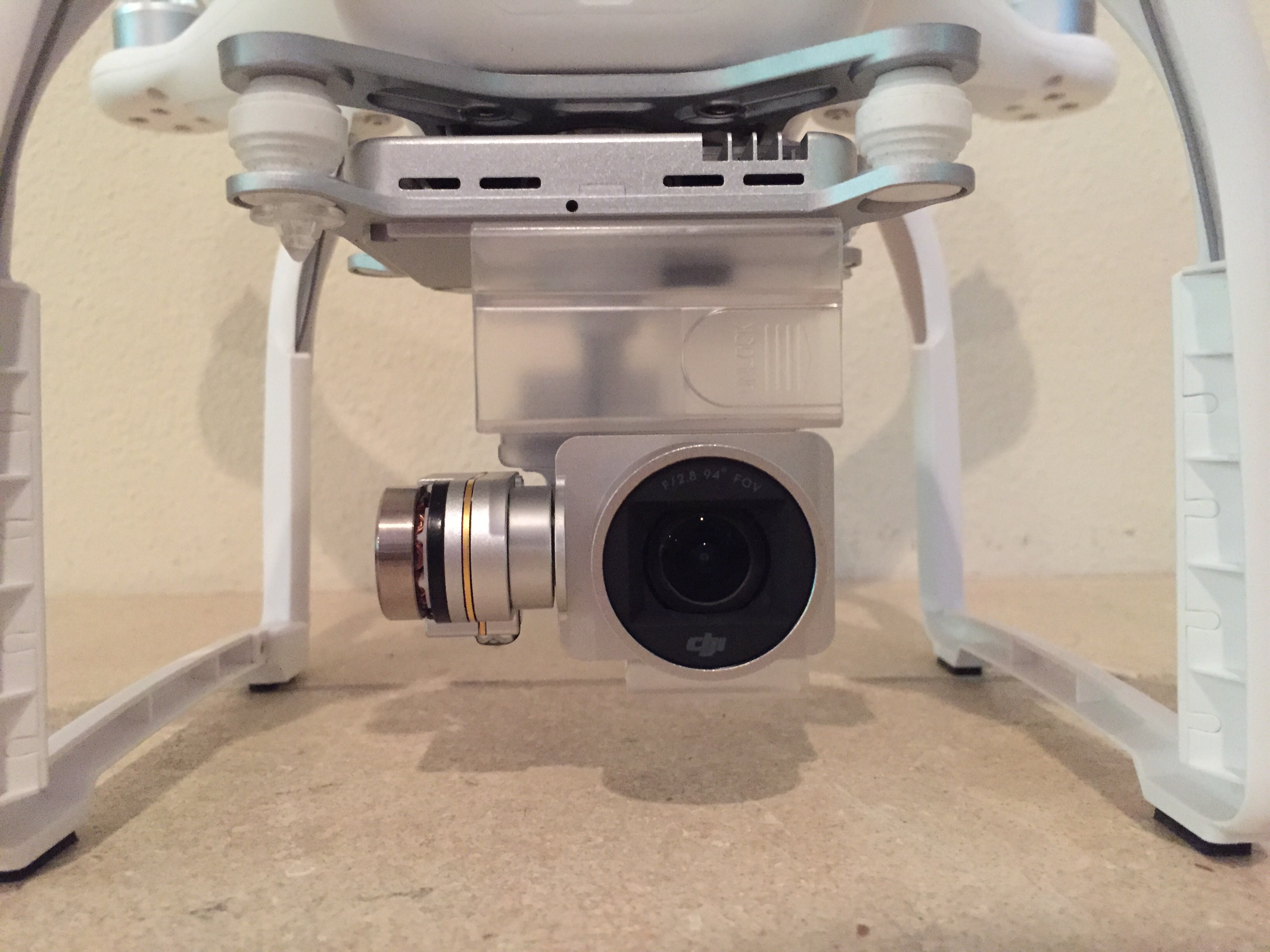

    Ok with you guys if we get back to the original topic?
    My gimbal clamp looks straight to me:
    My P3 arrived with the clamp falling off and it took me a day or 2 to figure out how it's supposed to attach. Before that it would be crooked and feel like it was binding. The way it sits now there is just the perfect amount of clearance to be able to wiggle the camera slightly in all axis, so I know it's not putting pressure on any pivot points.
    I think my clamp was installed wrong at the factory. No way it would fall off the way it is now. The funny thing is now I can't figure out how I was able to get it lined up wrong at first.
