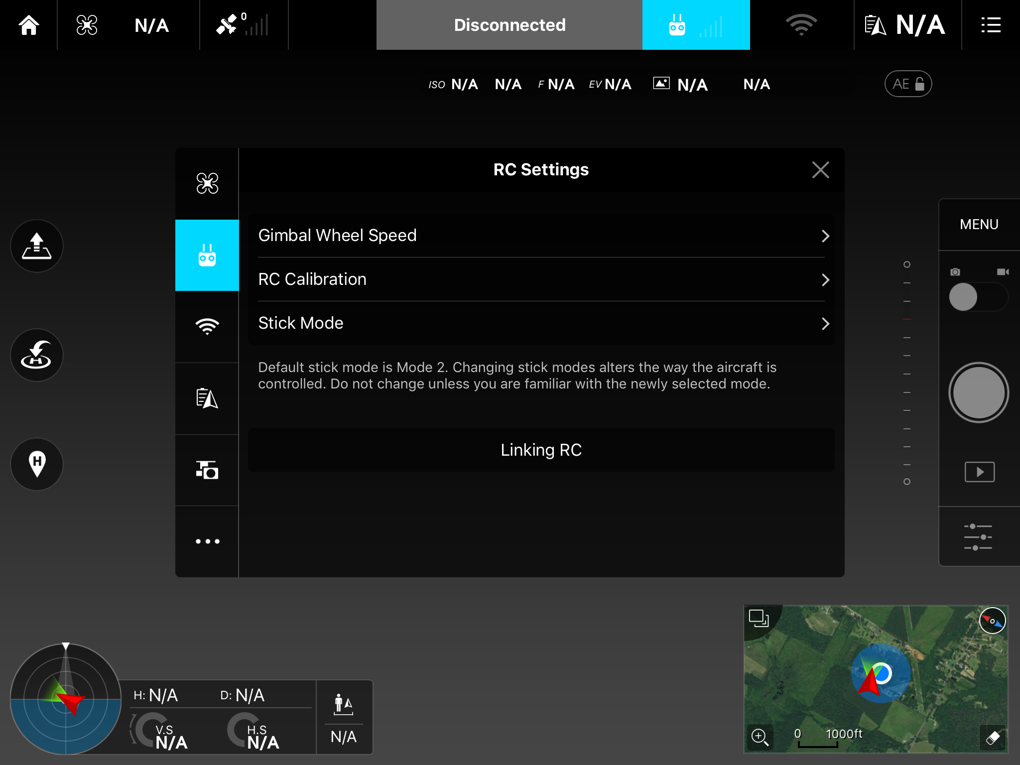

There are different modes in the app-- check them out. It does take some getting used to if you fly planes.I have had my P3P for a few weeks now, and the forward for down and back for up is really messing with me. It's backward from a plane. Pull back equals climb and push forward is down.
Is there a way to reverse it?

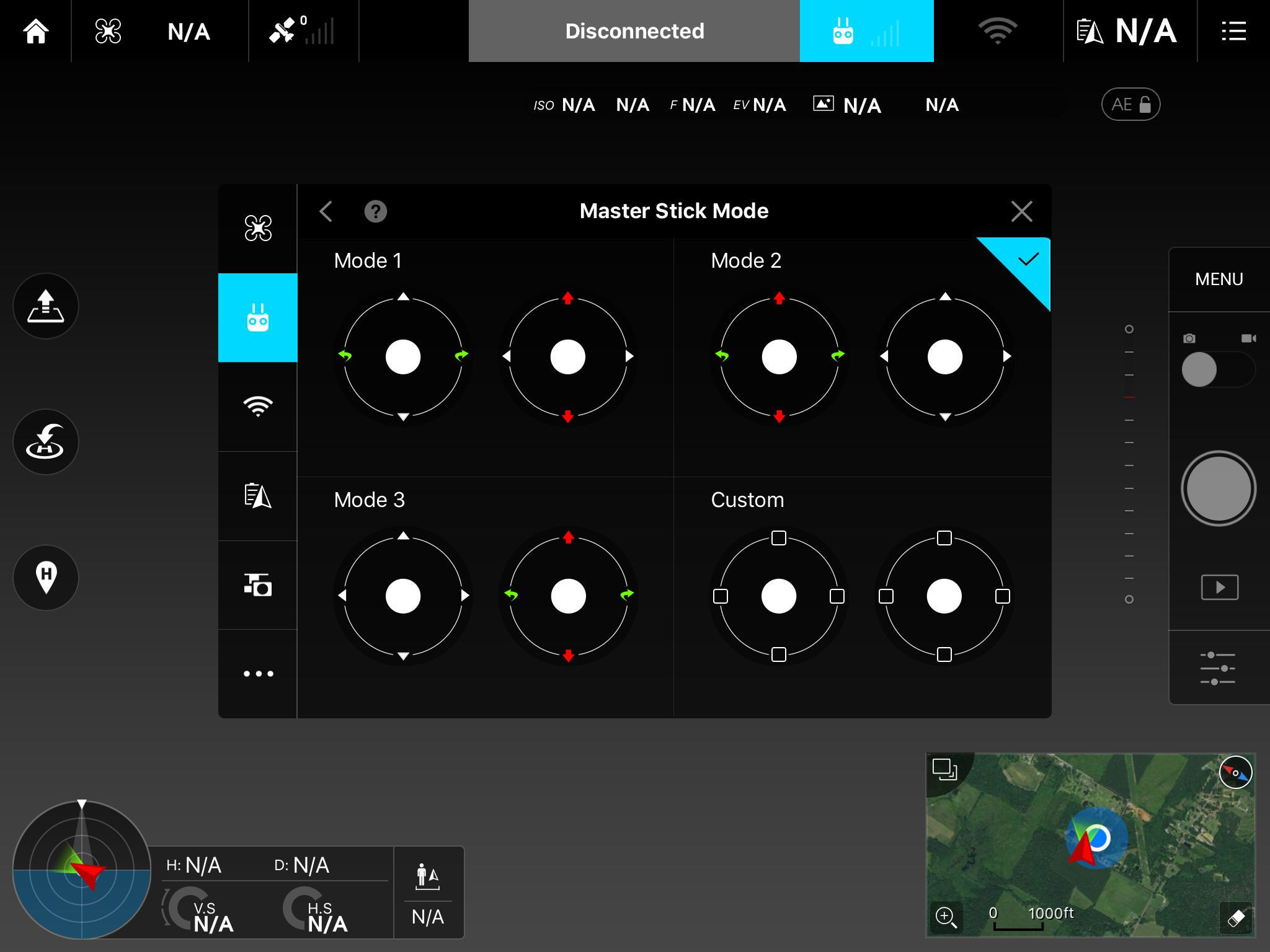

I assume you are trying to start them like normal but would think if you change the way you use the sticks that would change too.hi i have tried using this part of the app to change stick control but when i change it to something different than mode 2 the engines wont fire up
Well you must know how to fire them up in mode 2 so if you change the sticks try doing it up and in or something .many thanks for your help but im not too sure on how to do that as ive only had my p3 pro for a few days
Not sure here either-- never experimented changing the mode ??? Don't have time to try it tonight, but will give it a whirl tomorrow and see what happensWell you must know how to fire them up in mode 2 so if you change the sticks try doing it up and in or something .

OK-- Dirk-- you got my curiosity up-- so I went in under the Custom Mode and made the forward left stick down and back left stick up. To arm the motors push the left stick forward and left and the right stick back and right. To stop the motors, push the left stick all the way forward.Well you must know how to fire them up in mode 2 so if you change the sticks try doing it up and in or something .

You da man bob I did just look in the app but thought ....NaaaaOK-- Dirk-- you got my curiosity up-- so I went in under the Custom Mode and made the forward left stick down and back left stick up. To arm the motors push the left stick forward and left and the right stick back and right. To stop the motors, push the left stick all the way forward.
@oakmeadows-- FLY AT YOUR OWN RISK and let me know if it works.
