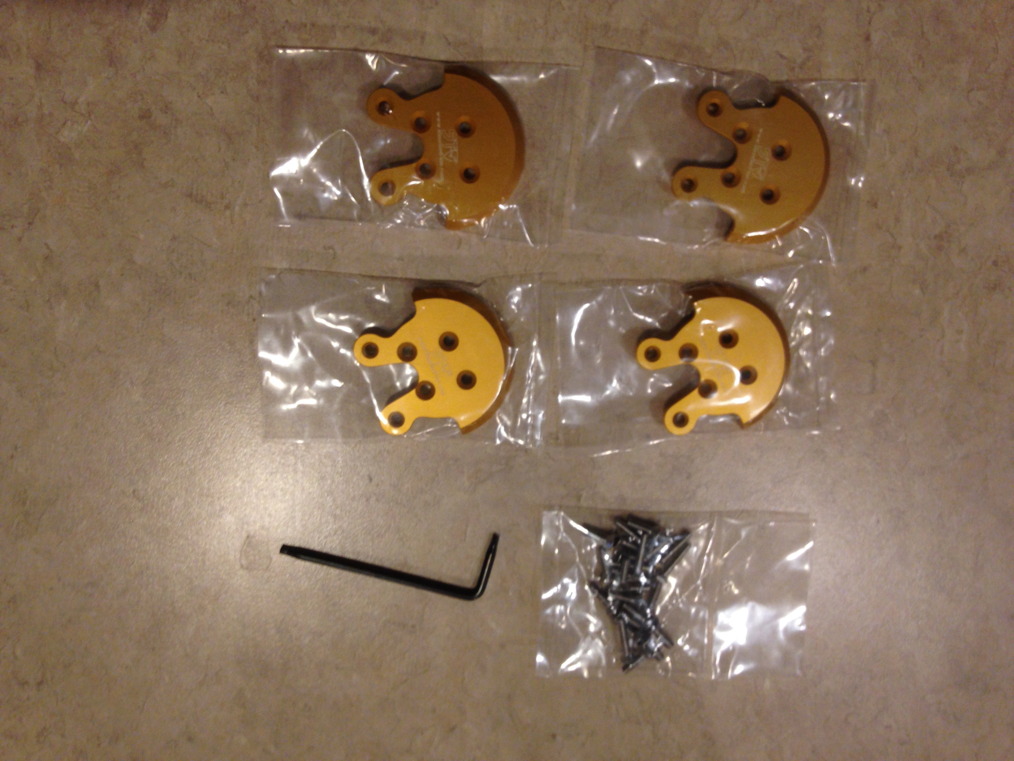

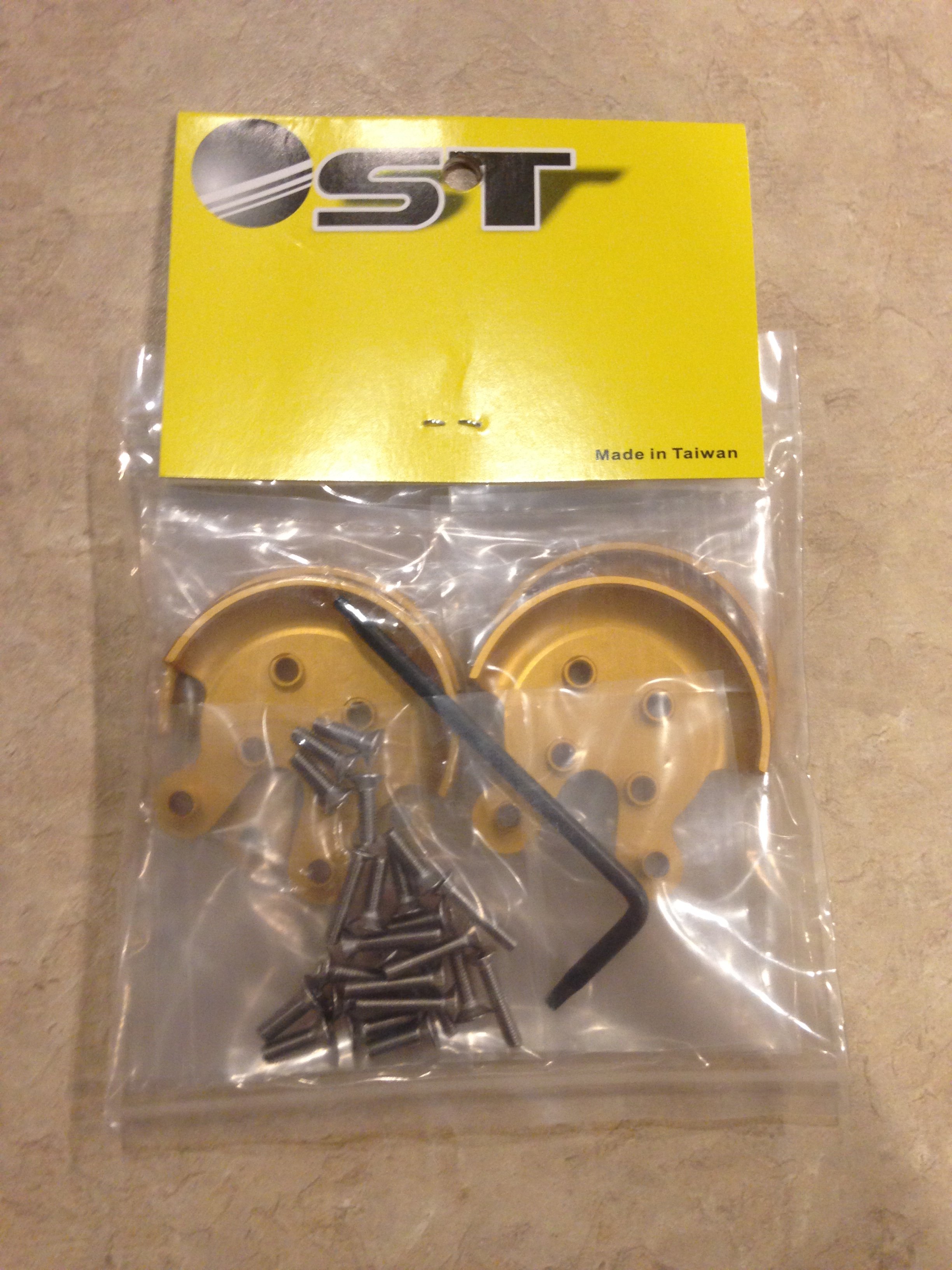

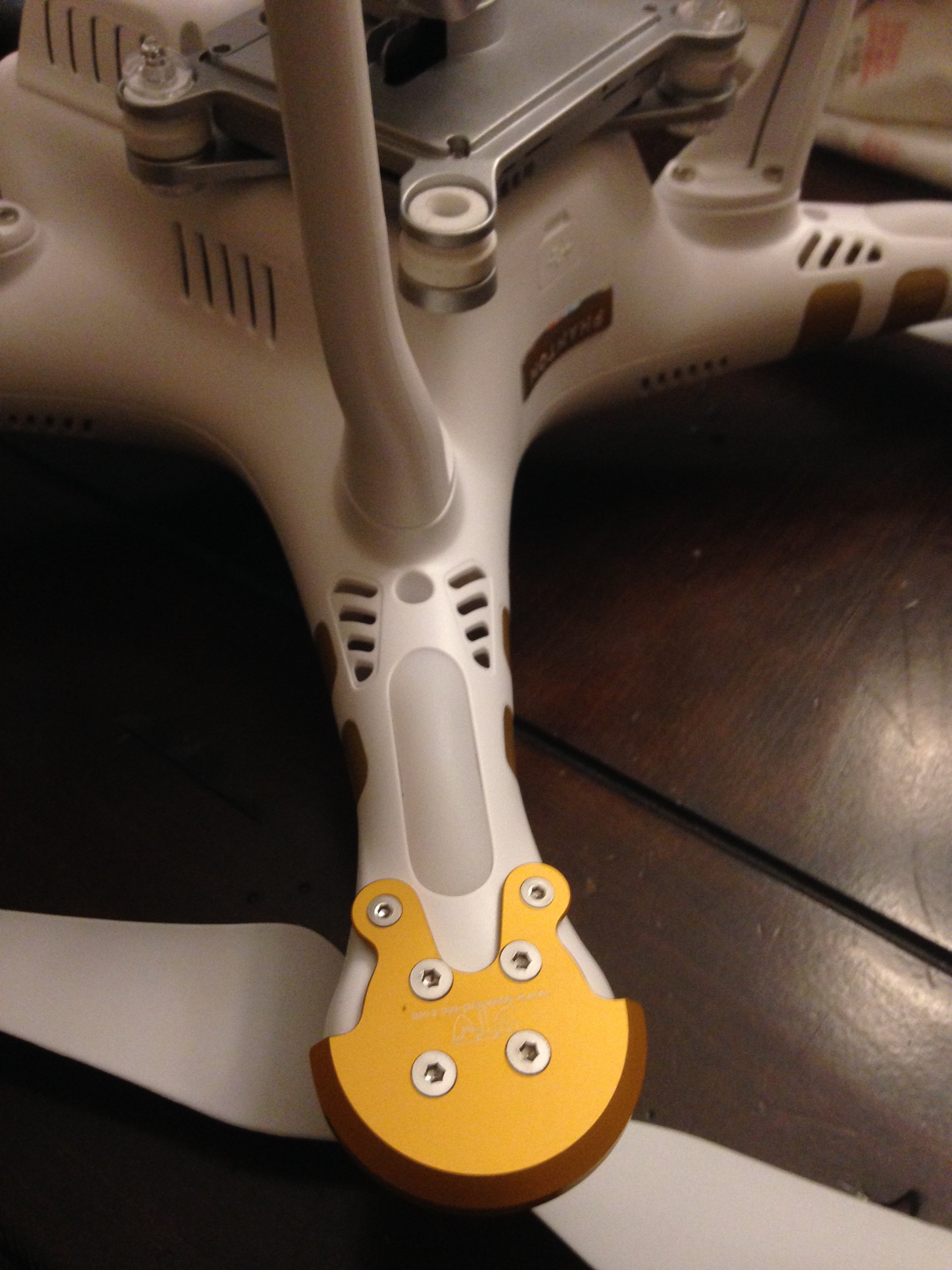

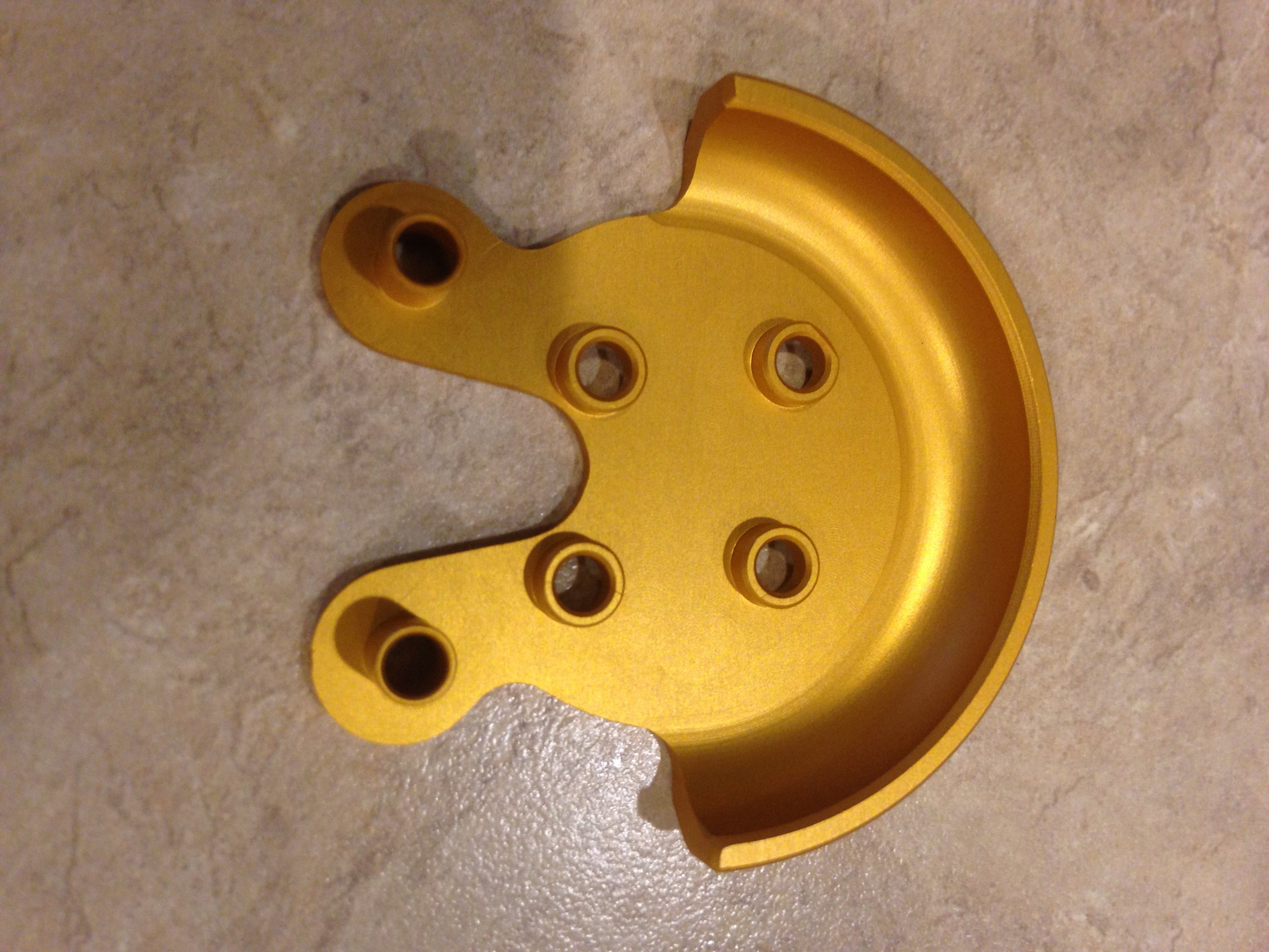

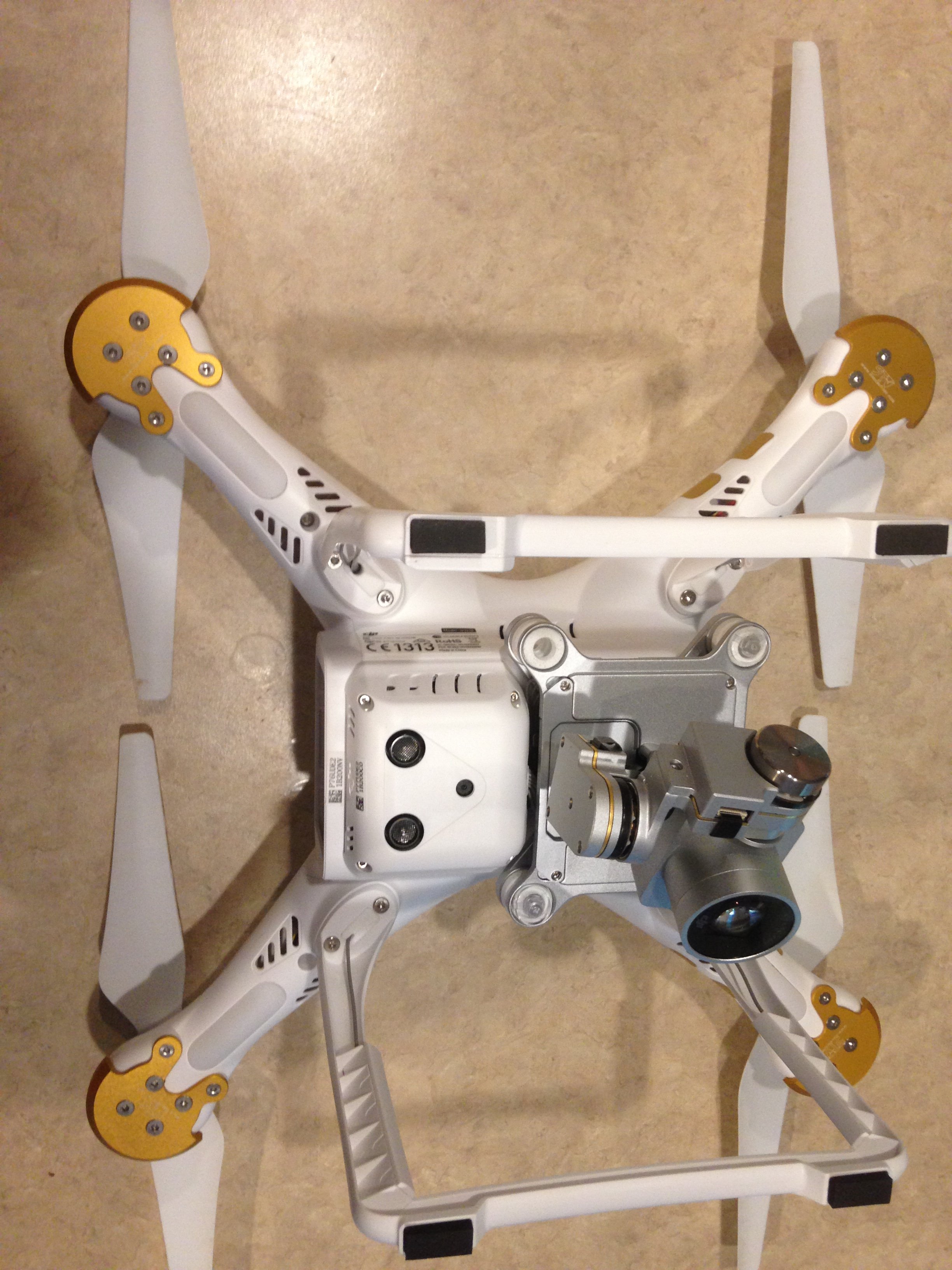

    Having spent a few days with these I can say that I am initially very impressed.
    Total cost including shipping was $37 so they are on the expensive side but seem very well made.
    The material used is aluminum and the gold color goes well with the P3P theme (I noticed silver was available for the P3A).

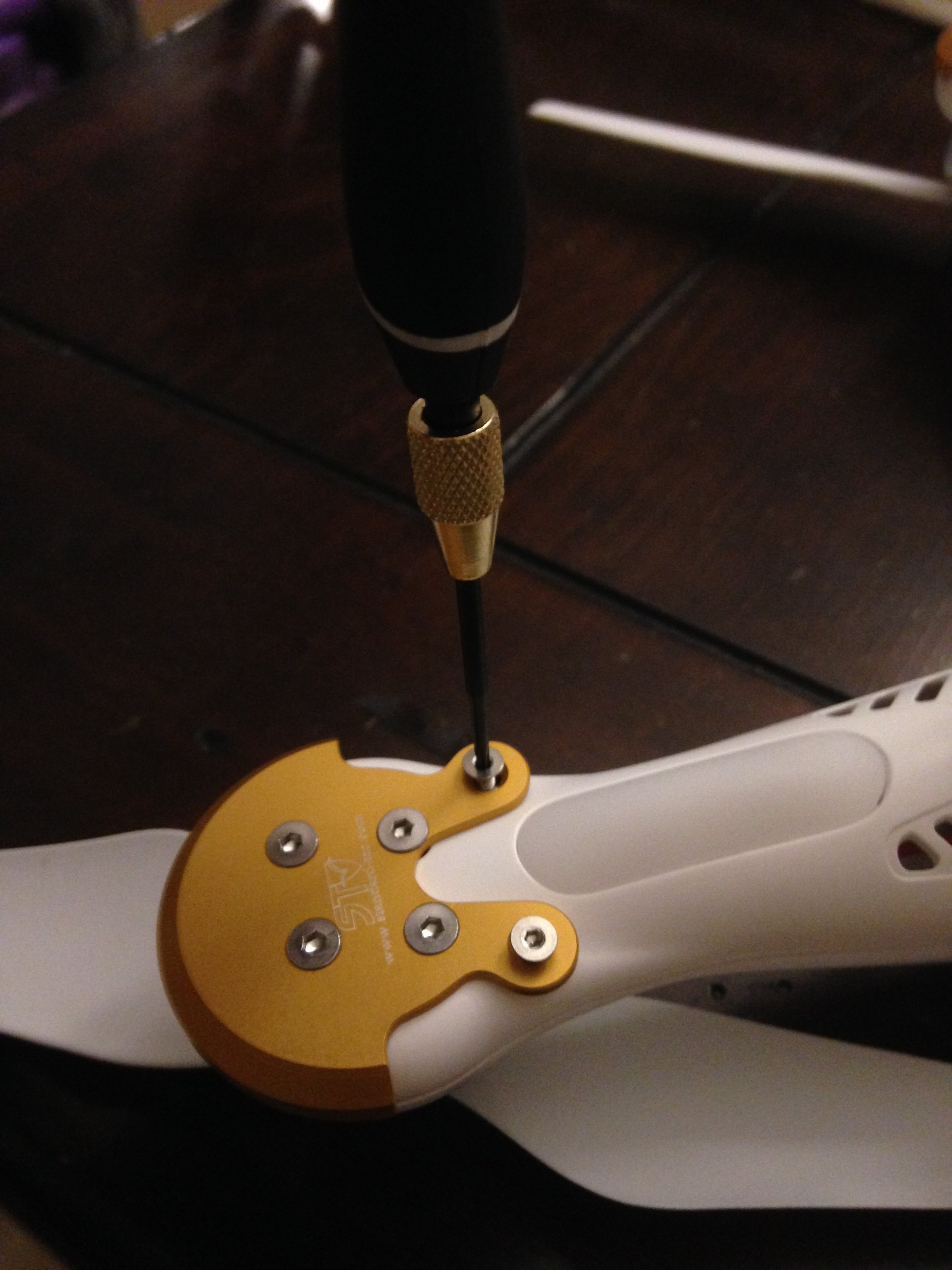

    The kit includes all the screws and a T8 wrench to remove the original hardware.
    You will need a T6 and a T8 torx to perform the install because the kit's screws for the 2 inner shell connections use a T6.
    I will note here that those 2 inner screws seem to be the source of most the cracks and indeed have been where both my W323A and W323B shells have had the issue. The factory screws on the W323B were NOT over tight from the factory as some have theorized is the cause but was not the case here.
    The kit does not indicate if loctite should be used and I decided not to because of the previous posts regarding plastic deterioration opting to simply check them from time to time

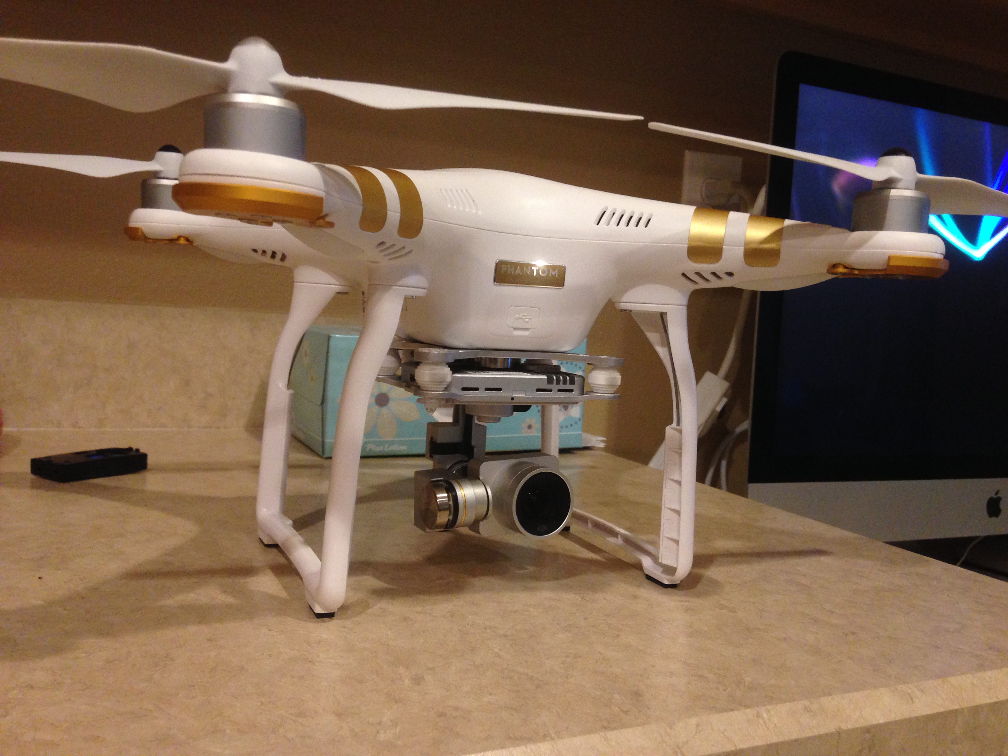

    I have not noticed any decrease in battery life with the slight added weight nor does the material seem to have an effect on the RF signal.

    I have these on my P3P in silver and after today's flight I have a crack. I have owned my P3 for 8 months and 98 flights.

    I removed them the other night when I was going to send my P3 to DJI. After giving it thought I'm not sending it in since I still have warranty and it's only the top.
    After putting the reinforcements back on I noticed the metal piece for those 2 screws does not go all the way in to the plastic. So yes, this might of helped this crack. If no one else got cracks than I would blame them totally.
    So this time I put the 4 motor screws in first as they are flush in the holes. Then I put the 2 other screws in until they were flush with the metal plate.
    As when I installed them 3 months ago I used a little clear nail polish as locktite on the screw ends only.
    I flew last night no issues either. Just going to enjoy the heck out of it.
    I just looked at the phantom and the crack is very hard to see now after re installing the plates.
    About 3 months.
