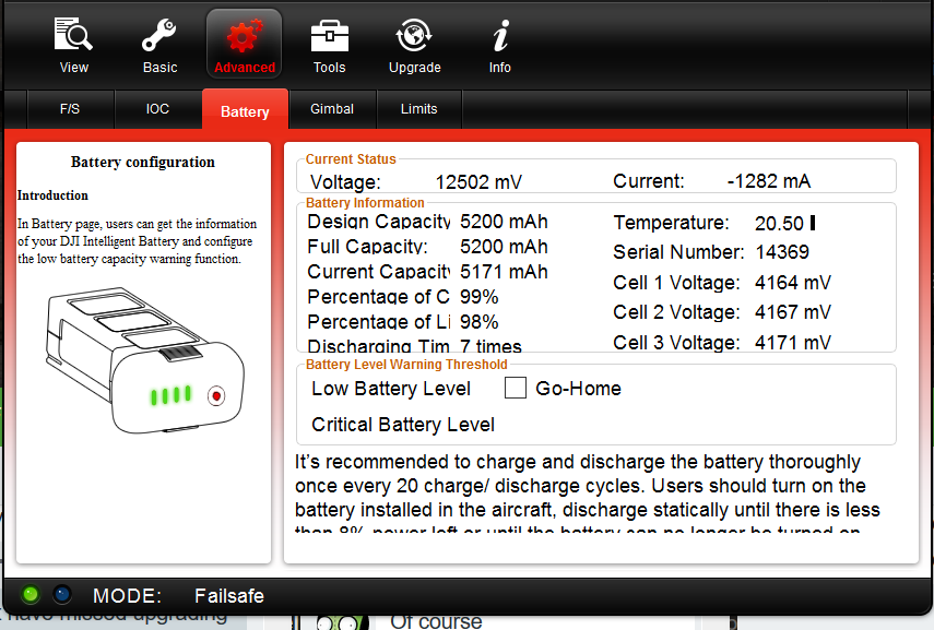

    Fully charge all 4 then check each in the P2 software for full and current capacities plus the voltage of all 3 cells . Take a screen shot of all four
    and post them If batteries are not maintained properly such as storing with a full charge for a month or more will shorten there usefulness or even look like this. To bad there isn't an easier way to check batteries then having to use the P2 assistant software.

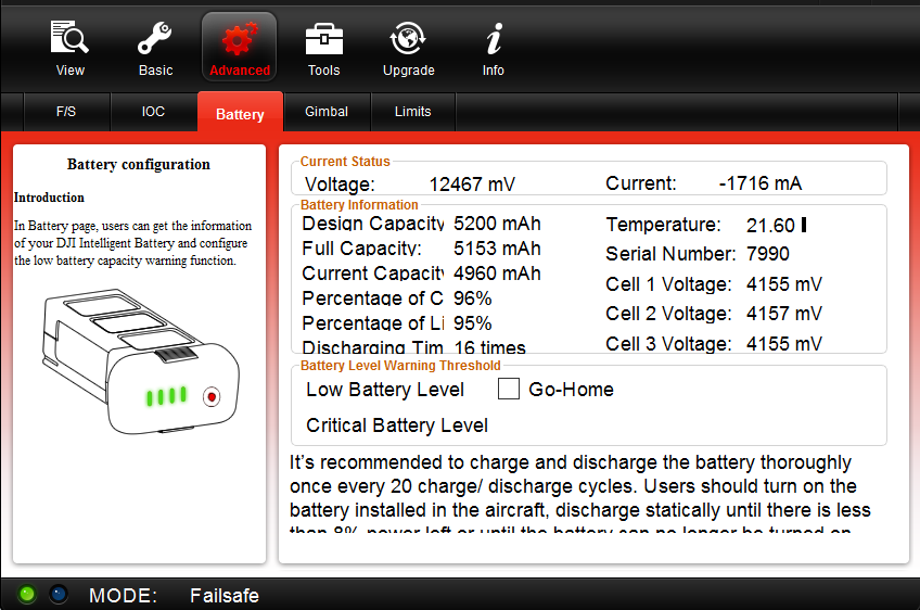

    Jason: Here they are

    The only one that's good in the newer battery with only 7 cycles the others were not maintained properly. But it is a shame that the only way to check these batteries is to spend the time connecting them to the software.
    You should replace all three with OEM replacements and not aftermarket batteries because the price is cheaper.

    Took them all out on a flight test today. Battery 1 (16 cycles) for some reason gave me 20 minutes of flight time whereas battery 3 (7 cycles) gave me 5m. This doesn't make sense to me. Can you help me decypher this logic?

    A good example is the screen shot I posted look at the three cell voltages then look at the current values. The P2 had just taken off when those LED's change from green to red so I like you land it and changed the battery. But I did do anything with battery for weeks. When I did decide to check it it had about 60% charge and had the damaged cell warning .so I discharge it to 8% and recharged it.then check it again and you see the results.
