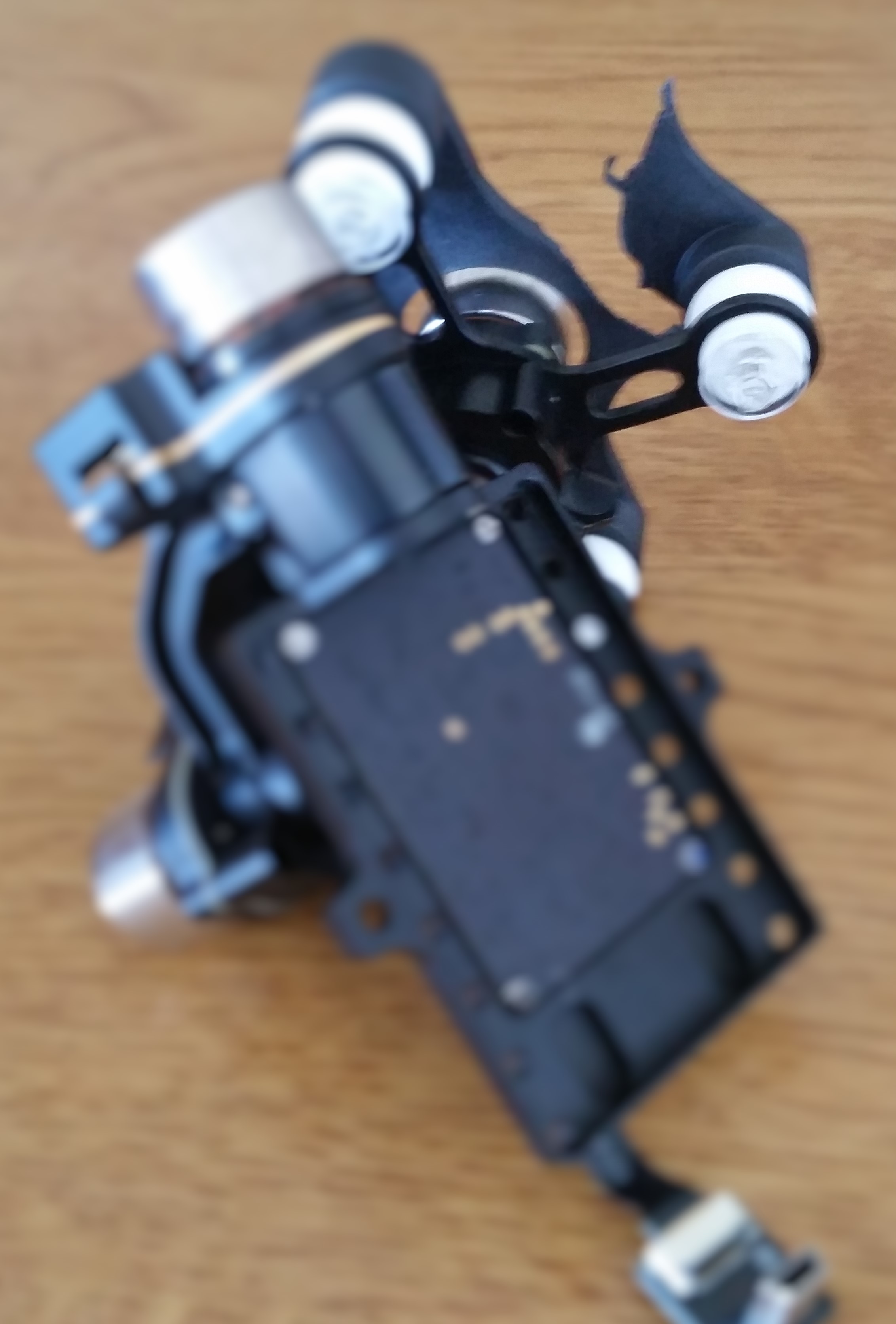

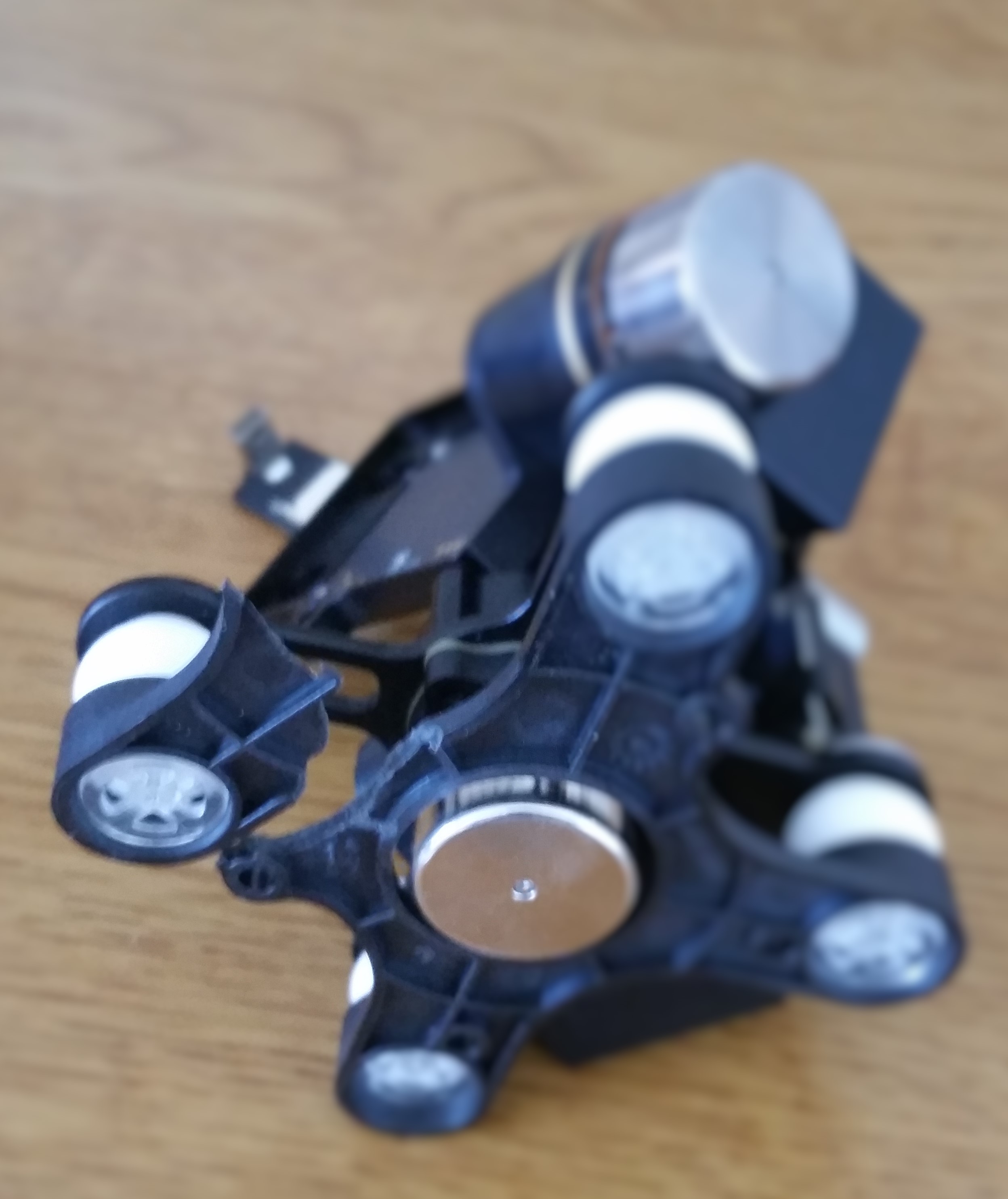

    I was flying my P2 back to my villa while walking behind it, decided I would try to fly it between two bushes and over the gate. "Try" was the key word. I hit one of the branches causing the P2 to flip upside-down. That made the drone fly into the ground. But... that wasn't the end of it. Once it hit the ground it continues to "fly", skipping along the ground until it hit a wall and I was finally able to stop the motors.
    Damage:
    Zenmuse H4-3D gimbal had one of the attachment legs snapped free of the base.
    Repairs:
    I used a new product I just found called "Bondic" that bills itself as a plastic welder. I had the gimbal fixed in about 10 minutes. Most of that time was taking it off the P2 and then putting it back on the P2. The actual repair took less than a minute!!

  7. Bob Mador
    Jan 10, 2016
    36
    Crete, Greece
    Here are the photos that no one can see because of permissions problems

  9. Bob Mador
    Jan 10, 2016
    36
    Crete, Greece
    Thanks for that link!! I ordered a new part and the dampners and plastic posts.
    I used a product that claims to be a "Plastic Welder". I saw it online at www.itsnotaglue.com
    I was able to repair the damage in under a minute with that product!
    I will charge my battery, re-cali the gimbal, and test fly it tomorrow

    I finally had decent weather and time to test fly my P2 after repairing the crash damage and re-cali the IMU. It flew great :)!!
    Here's a photo of the repair:
