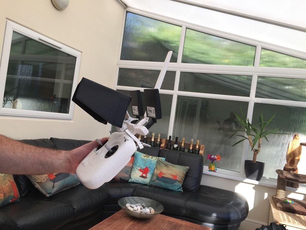

  4. Rip
    Rip
    Nov 2, 2016
    188
    51
    So like this?
    [​IMG]
  5. PaulSouthport
    Sep 1, 2016
    701
    307
    Southport, UK
    Yes, although I would tip the long antenna back parallel with the panels, the face of it should be pointing to the phantom, not the tip
  6. Rip
    Rip
    Nov 2, 2016
    188
    51
    Got it, thanks!
