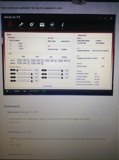

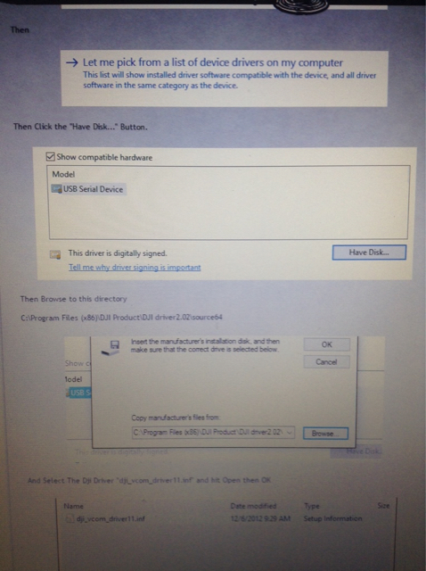

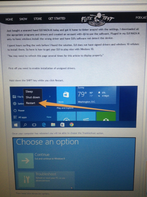

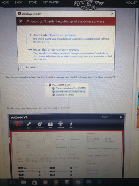

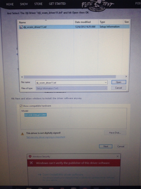

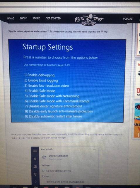

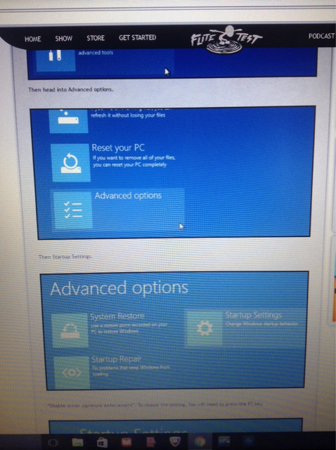

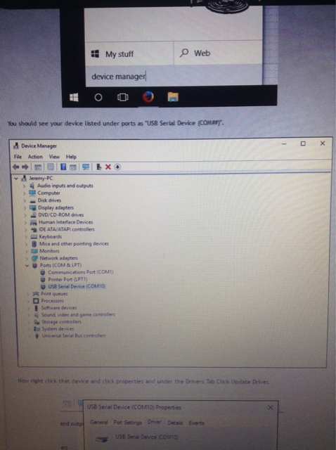

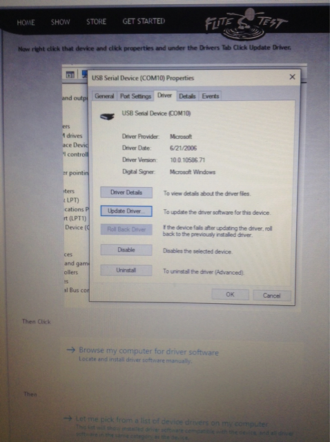

    ImageUploadedByPhantomPilots1468079472.882770.jpg ImageUploadedByPhantomPilots1468079492.881436.jpg ImageUploadedByPhantomPilots1468079514.632048.jpg ImageUploadedByPhantomPilots1468079586.798095.jpg ImageUploadedByPhantomPilots1468079641.330855.jpg ImageUploadedByPhantomPilots1468079685.014519.jpg ImageUploadedByPhantomPilots1468079733.914371.jpg ImageUploadedByPhantomPilots1468079800.897974.jpg ImageUploadedByPhantomPilots1468079820.565336.jpg
    Hope this helps
    #1 MauTech, Jul 9, 2016

    hey once i make it to the part where you select "have disk" then you have to browse to the file. well i make it all the way to dji product file there is no file named dji driver, then no file name source64. help??
