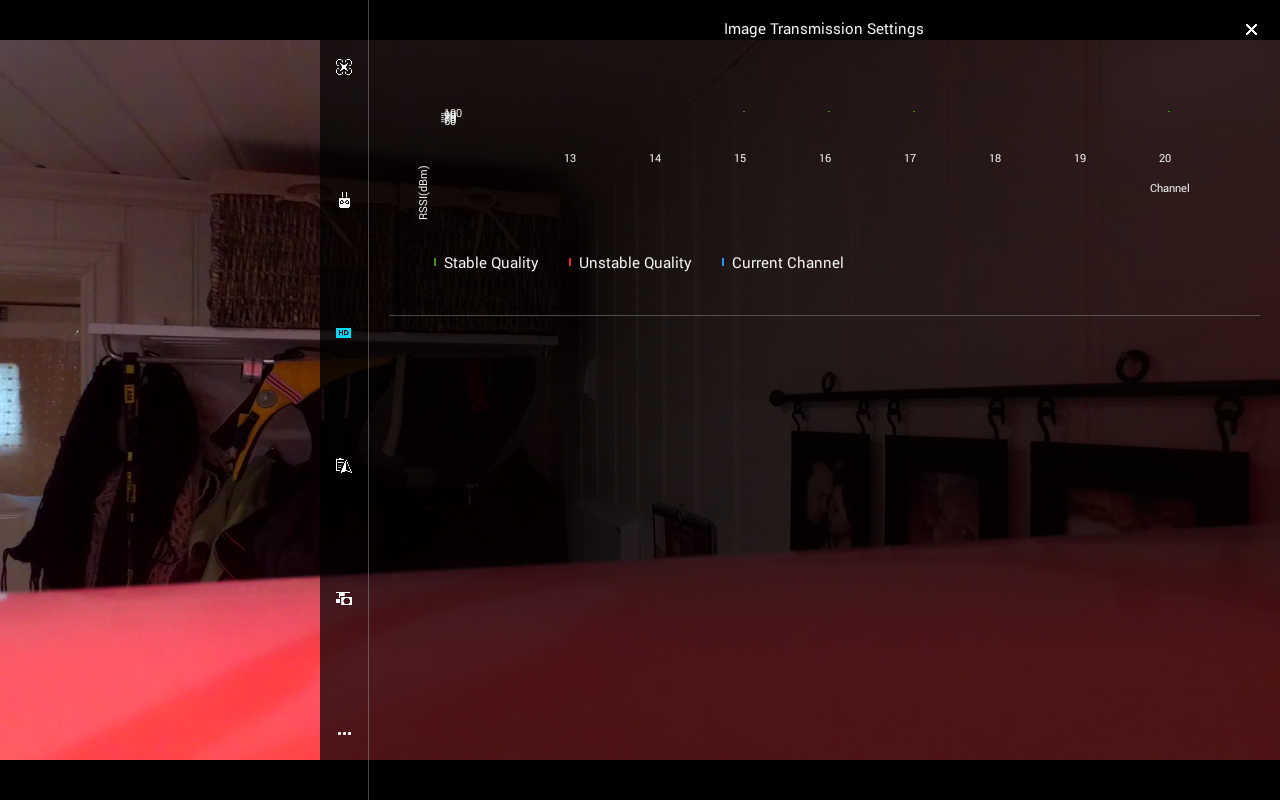

  3. Patrick Pedersen
    Apr 10, 2016
    36
    4
    Fredrikstad, Norway
    This is a screenshot of the screen without the drone on, when the drone is on I don't get to choose which channel I want to use. App version 2.7.2 Android
  4. Bob Hyslop
    Jan 12, 2016
    52
    12
    Yep, same as me.
    I spent nearly 2hrs online to dji support to be told its the tablet I'm using causing this as its not on the supported list.
    I'm using a hipstreet electron I bought with the drone.
    I change the language settings on the tablet to English (us) and that did give more control but still couldn't see channels on graph.
    I have flown it like this and had no problems but the dji ##### said they can't say it wouldn't have flight issue's and to by a device on the supported list.
    Gonna borrow another device see if that makes a difference.

    The screenshot Patrick is showing IS with everything powered up.
    When app only on you get this

    Ok, With The Birds, now I've been out trying the drone and RC. It seems like I can choose channel once I turn the RC off and then on again, then the screen looks like this:
    But when I go out of the HD menu and in again it goes back to:
    And the channel in use is back to 13! Even though I managed to get it to f.I. channel 18 or 20.
