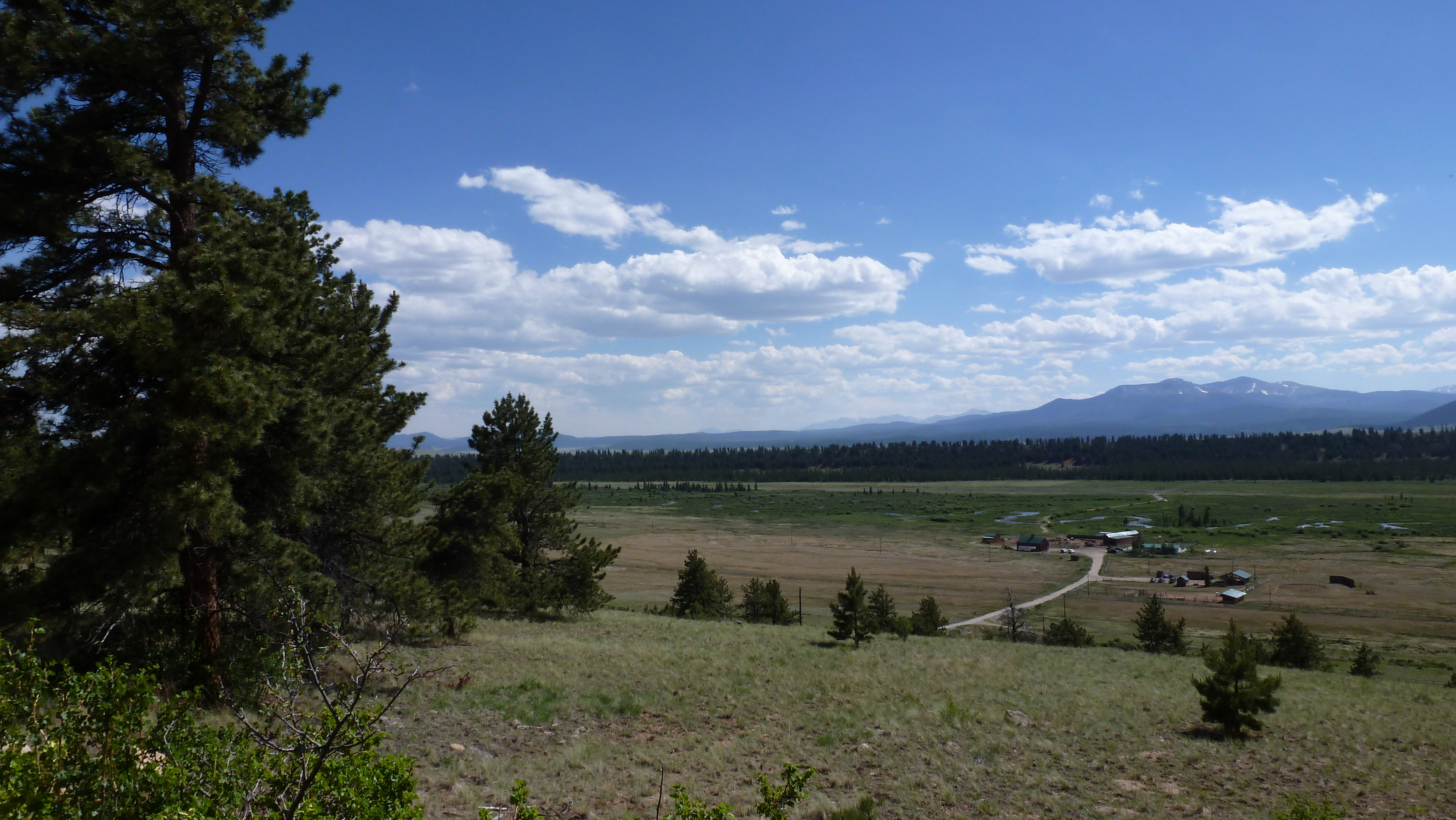

    Somewhat a newbie here. Have a question, coming from Michigan and now at my new home in Colorado I'm planning on taking my new P4 up to my property in the Mountains to fly. Lots of open space and not much to bother your flying up there. I'm going to be starting out at about 9600 feet what concerns should I have at the altitude? P1030680.JPG

    Your property looks like it has lots of nice open space and fairly flat. You can see our place is surrounded by trees and is on the mountain, which makes for interesting flying to ensure you don't collide with trees on the "high" side which can be many feet higher than on the low side. Because our place and area is surrounded by trees, I rarely fly in Sport mode.
