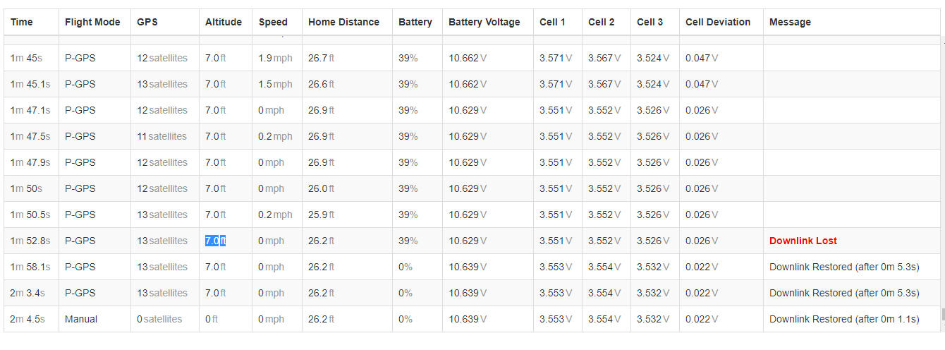

Ok, as I originally said, this appears to be a momentary power loss. As to the cause? Unknown at this point. This power loss co-incided almost identically with the downlink signal that was lost, so the data is a bit skewed at best due to that. However you can see by this that for the last few seconds, the motors did shut off, along with most everything else, and then came back at the last second. Of coarse with the signal loss issue I don't think I can determine more fully what the issue actually was. The best I can say right now is a momentary loss of power, which caused the motors to shut down. Naturally, they don't re-start themselves. That said, if you wish to look in to this more thoroughly, I suggest you pull the .dat file from the AC. Here is a link with instructions if you wish to do that. If you do, you will need to upload that file to a sharable location, such as dropbox, google drive etc...and share a link back here to that.
How to retrieve a V3 .DAT File from the AC
