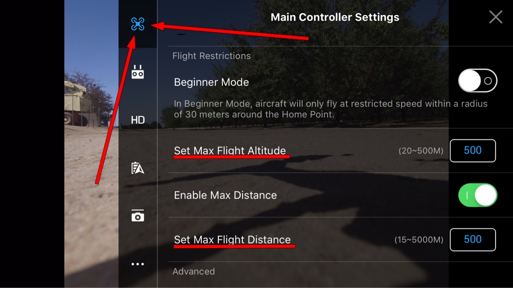

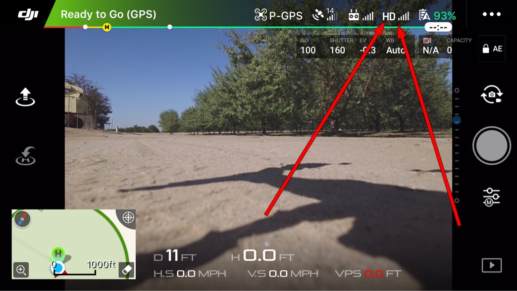

    First tap on the "HD" icon.
    Then select the top settings option.
    Scroll to the bottom and adjust your "Max Flight Altitude" & "Max Flight Distance"
