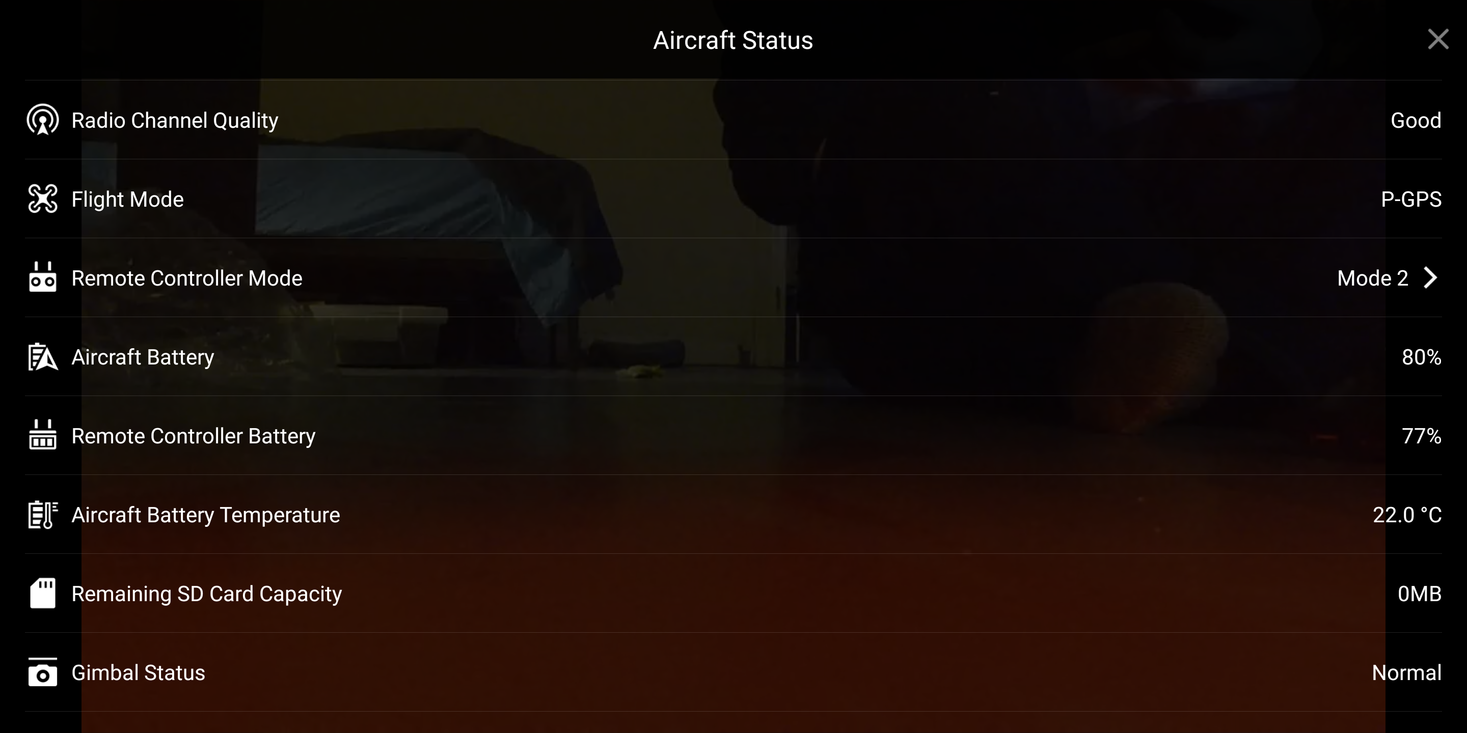

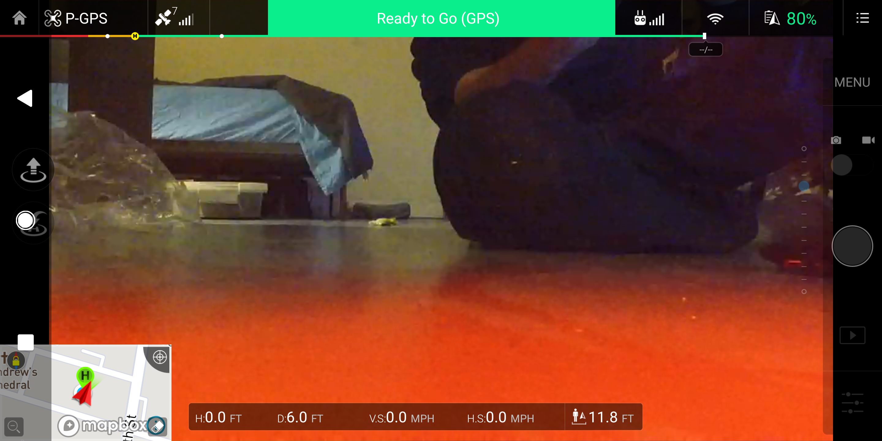

I have replaced the ribbon cable on my gimbal and the gimbal and camera seem to be working well now. I can start the drone and fly around with the camera being kept level and the video preview showing in my phone. However all the camera controls are grayed out, and my SD card seems to not be recognized. I can't format the SD card because the button to open the options is greyed out. I even tried formatting the SD card in my laptop but that didn't help.
I'm also unable to do a firmware upgrade, it fails just under 50%.
Has anyone seen this before, should I just try a different SD card?I'm usually ng a SanDisk ultra 16 gb right now. Thanks!

I've seen this when using a bad SD card. Should be a pretty simple fix. Best of luck!

Agreed, this issue is likely being caused by a bad/fussy sd card. Your first screenshot doesnt show the sd card status (you needed to scroll down abit more) but thats where you would format it in the AC. The fact you have live videofeed is a good sign.
