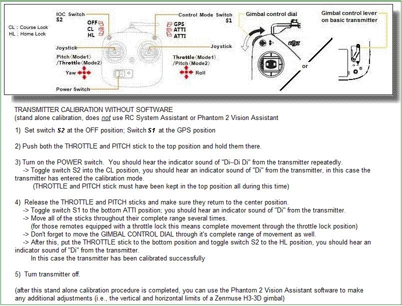

    try this:

    Thanks, however the RC that I have here is with out the gimbal lever on the back. This P2V+ only uses the app for gimbal tilt.

    Yes, I did follow that procedure and now have lost control of the RC to AC. Do I have to re bind them after this procedure? Whoops! This reply was directed to sdtag.
