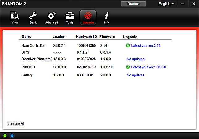

    I tried updating the software of the gimbal and the problem is basically that it does not keep the horizontal position. It is horizontal when the phantom is straight but if I bend it as if the phantom is moving sideways the camera align with the phantom and not with the horizon.
