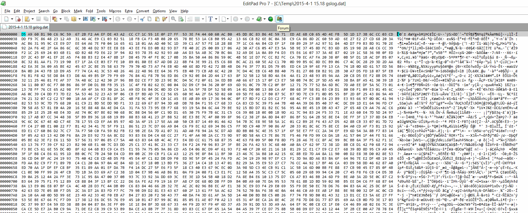

  6. dropke
    Jul 25, 2014
    81
    Antwerp
    Can You read the continance of the file ? I not he only gives me:
    see screenshot 'file size 140 KB
    Do You get more info ???
  7. dropke
    Jul 25, 2014
    81
    Antwerp
    Yes , thats all!!!!!!!
    I need the contents of those 140 KB !!!!probably Location, flyingtime ,distance ????????????
    dropke

  20. auen1
    Nov 1, 2014
    199
    43
    Nome,AK USA
    I believe the data is recorded by the isod into the ground station program.
    Screen shot where recorded below.
    The data is divided into eight columns.
    See reply #14 for more info.(Read by Editpad pro7 software)
    Data on the far left is binary and the data on the far right is ASCII, as far as I know.
    The data would be used to geotag your photos. AFAIK.
    #20 auen1, Apr 24, 2015
