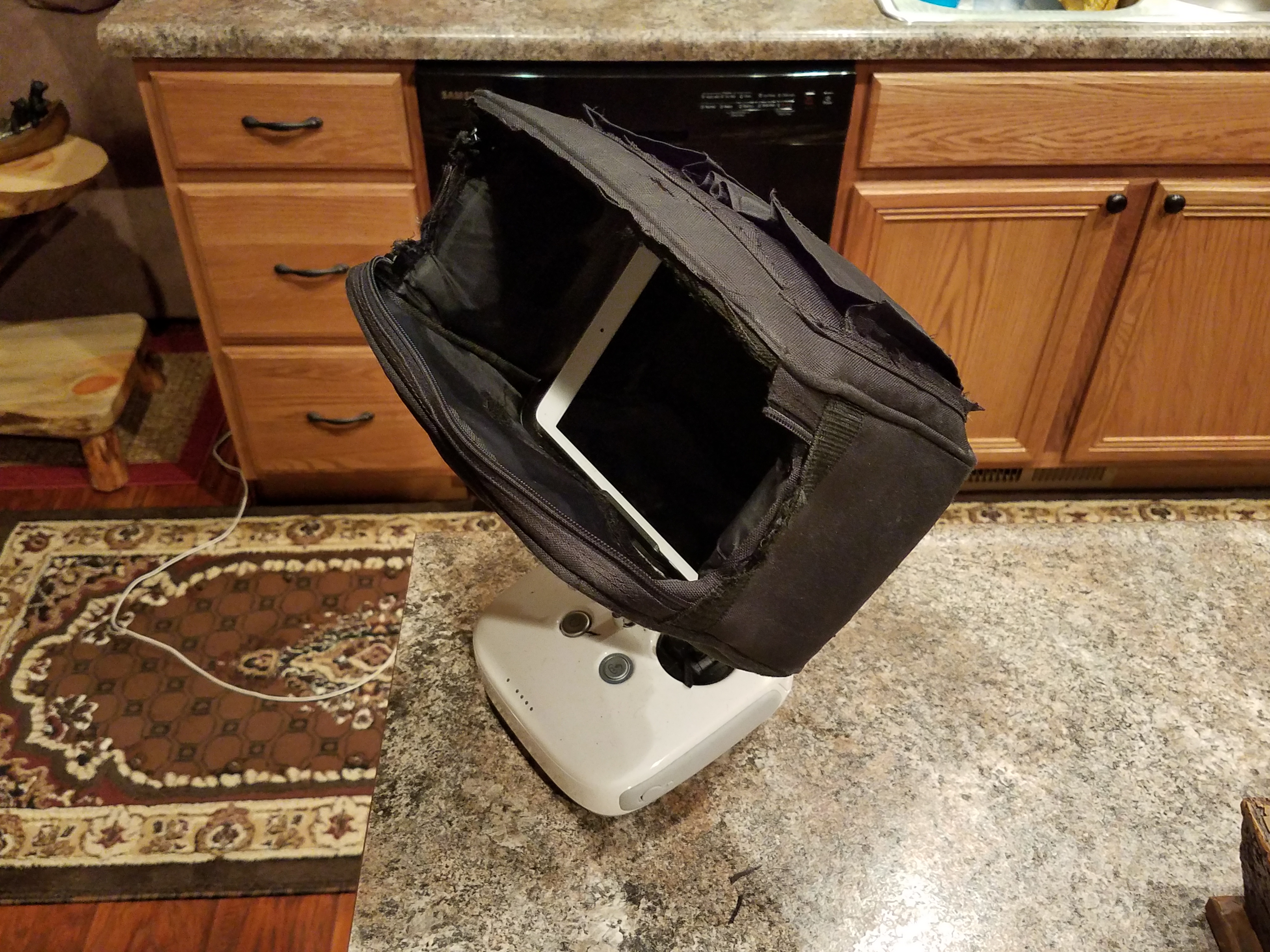

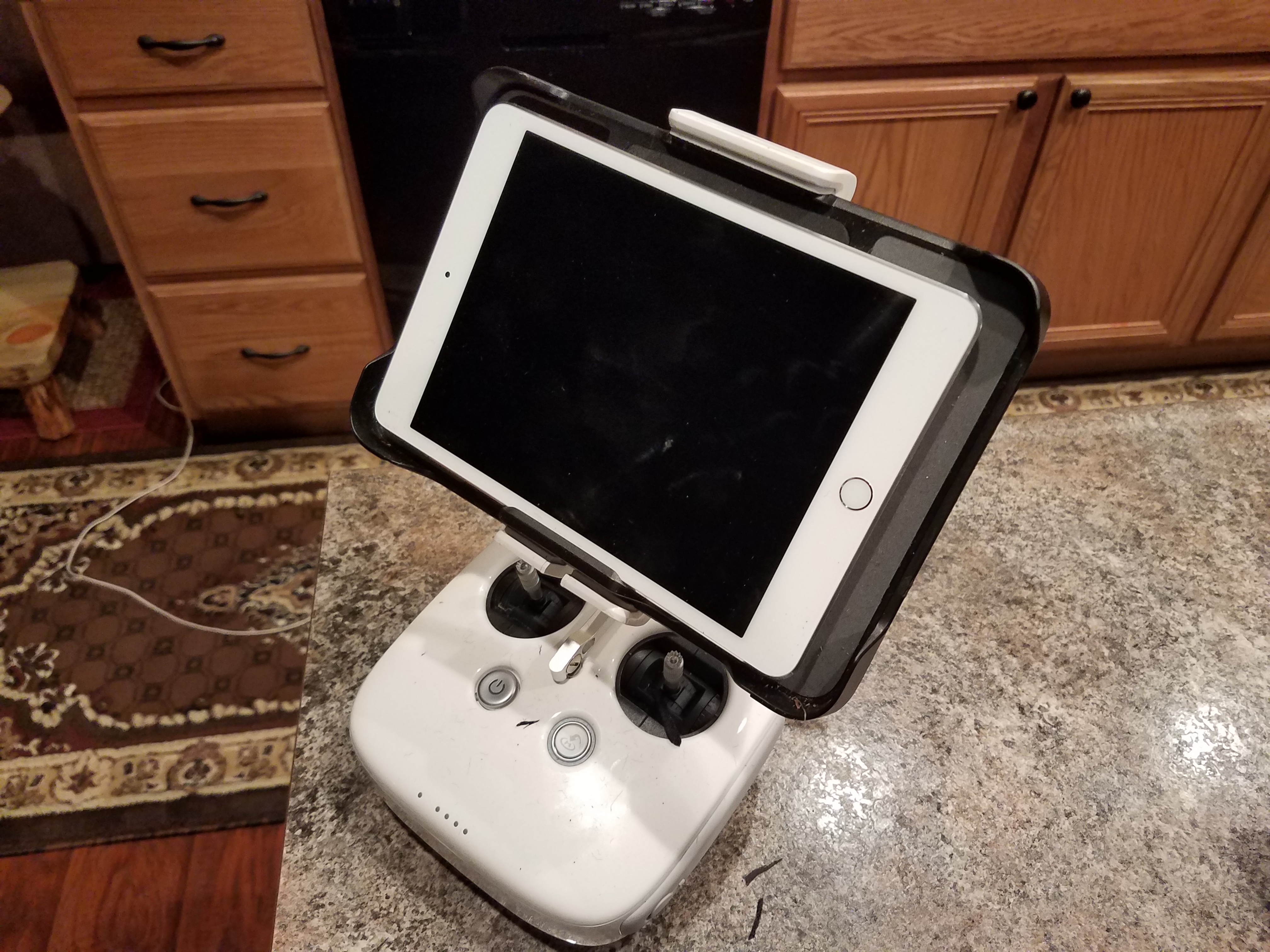

Howdy Folks! I discovered a new idea for a sunshade and it works really awesome and thought I would pass it on. First I went to Walmart and bought a $12 case for an iPad Mini 4 and cut the cover off and just using the hard plastic Base which holds the iPad itself. It works well and holds into the holder on your controller if you will notice the picture I provided. Next I got an old camera bag that's been in my closet for 15 years not being used or you could buy one at Walmart for $10 and cut the top off of that and cut the bottom out of it and slid it down over my iPad. The camera bag forms tightly right around the hard plastic case and give your iPad 360 degree sun shade. It may look a little redneck but It works absolutely great
