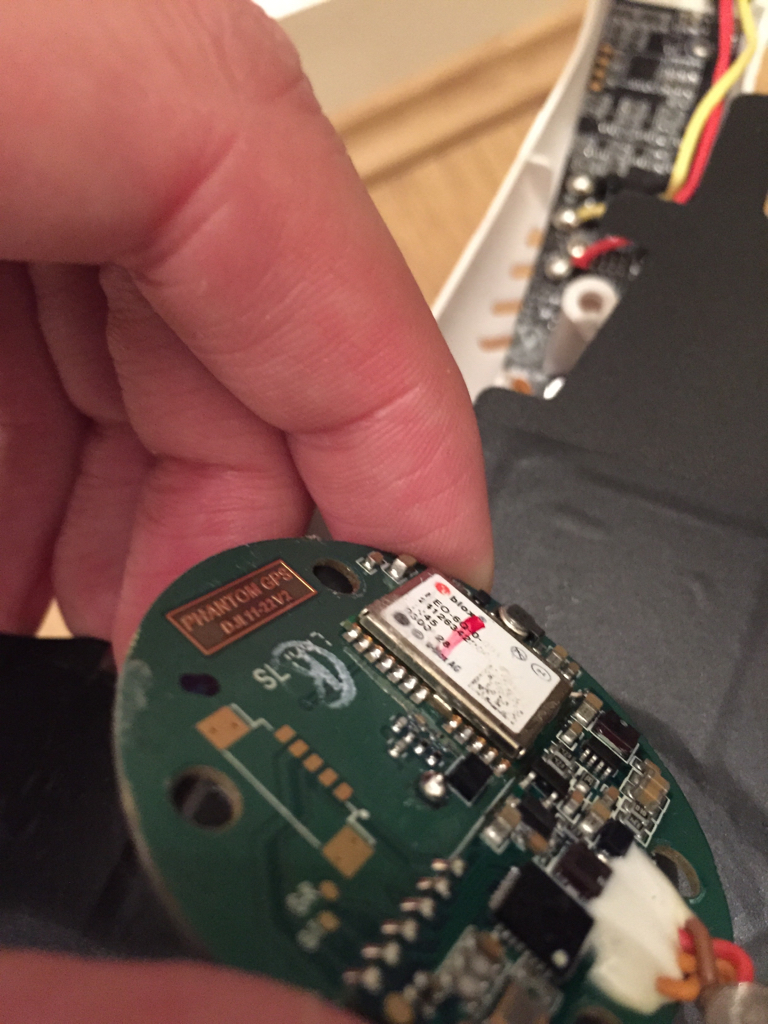

    I've just been out into a field where I've flown before with satellites and it picked up only 4 sats. Nothing more. It seems like something's loose or something?
    Is this solder joint okay with the puck? ImageUploadedByPhantomPilots - DJI Phantom Forum1442526497.572875.jpg

    2 things come to my mind, is the pin all the through the board, flush to it.
    and very thoroughly check the module for cracks or broken traces.
    its probably is worth resolding the pin just because no harm, and it might do the trick.
    good luck and have fun flying!

    I've checked the solder as I resoldered and the joint is good. The pin protrudes through the board to solder kirk.
    The module is brand new from buzzkill.
