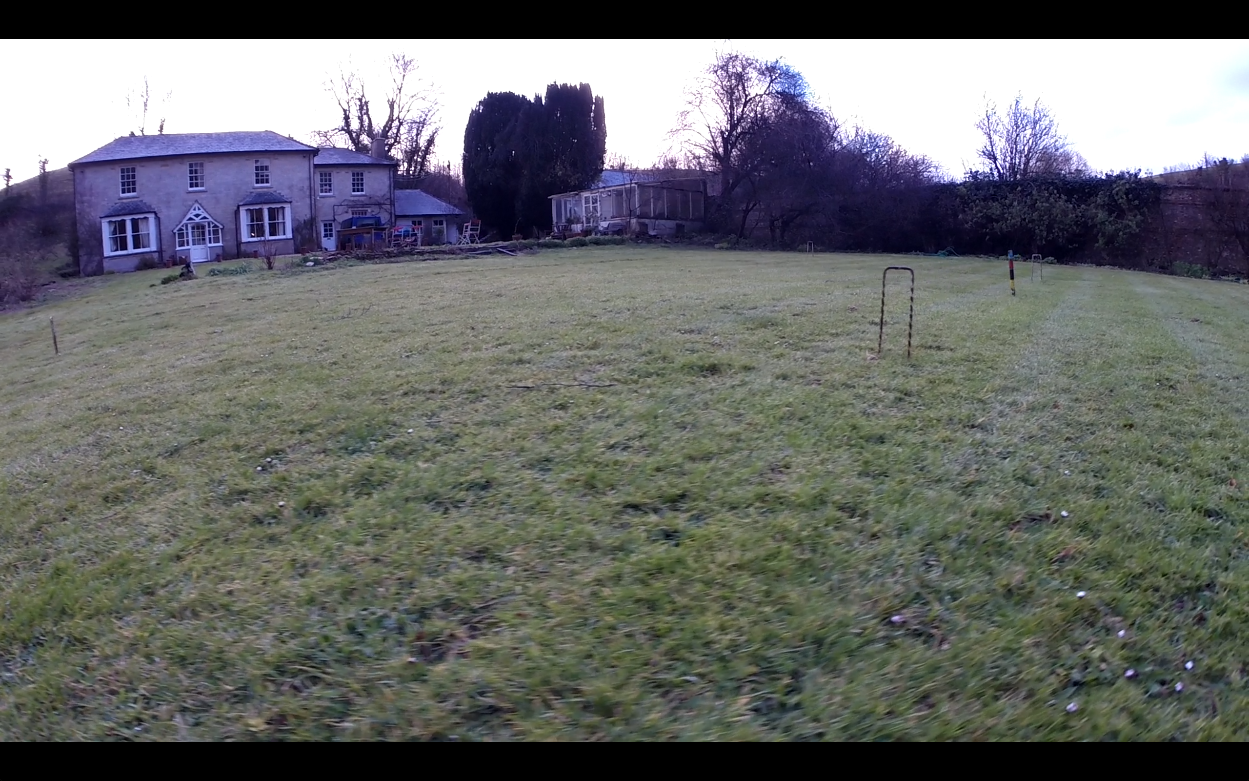

  6. Baldrick
    Jul 13, 2015
    101
    7
    United Kingdom

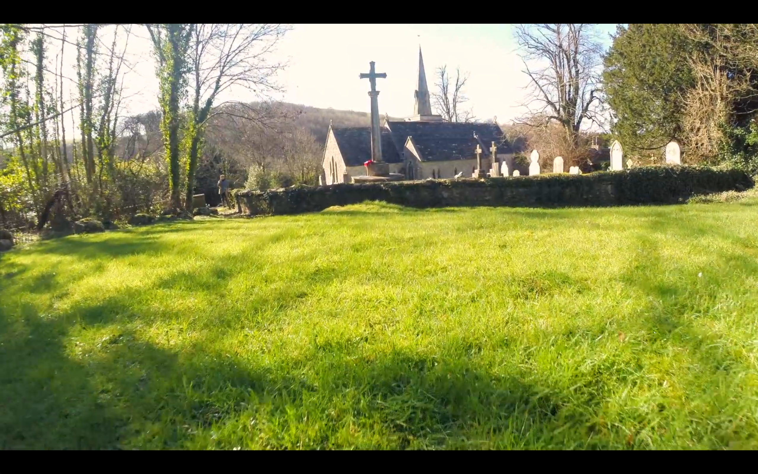

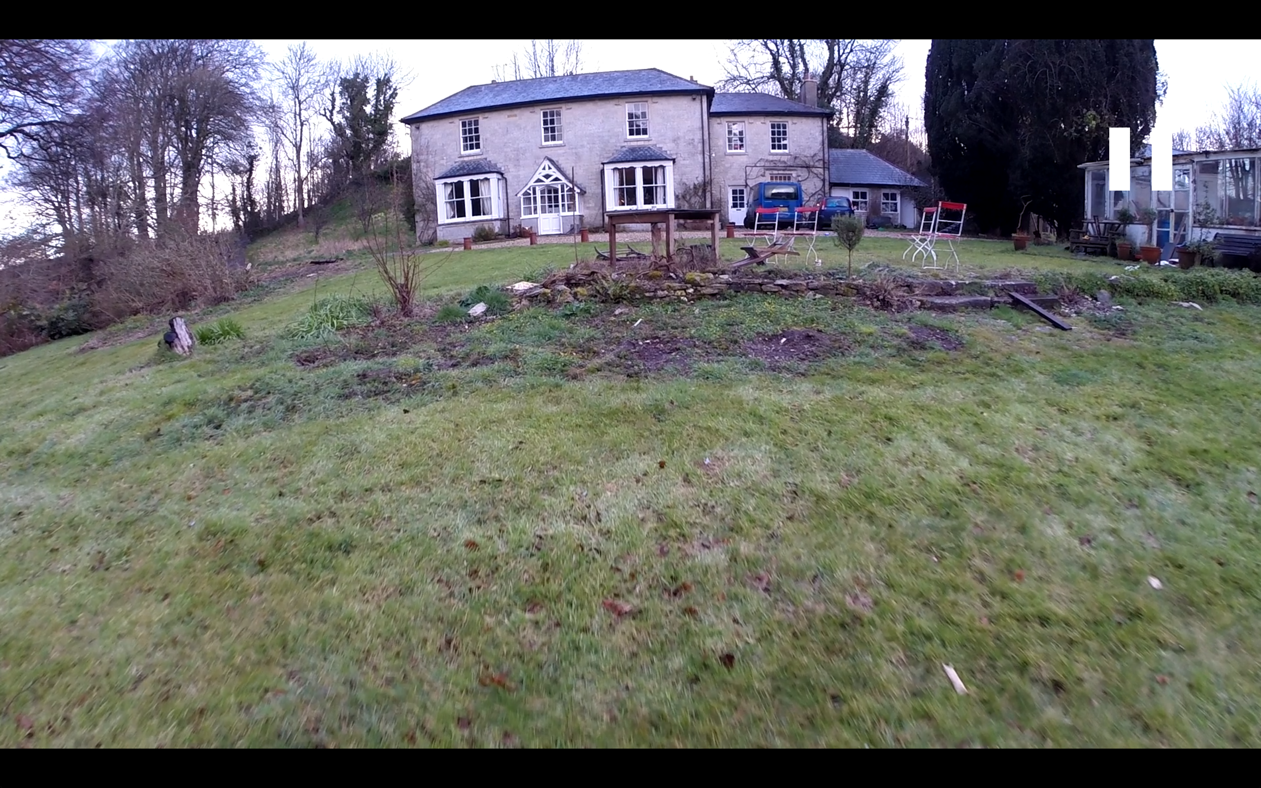

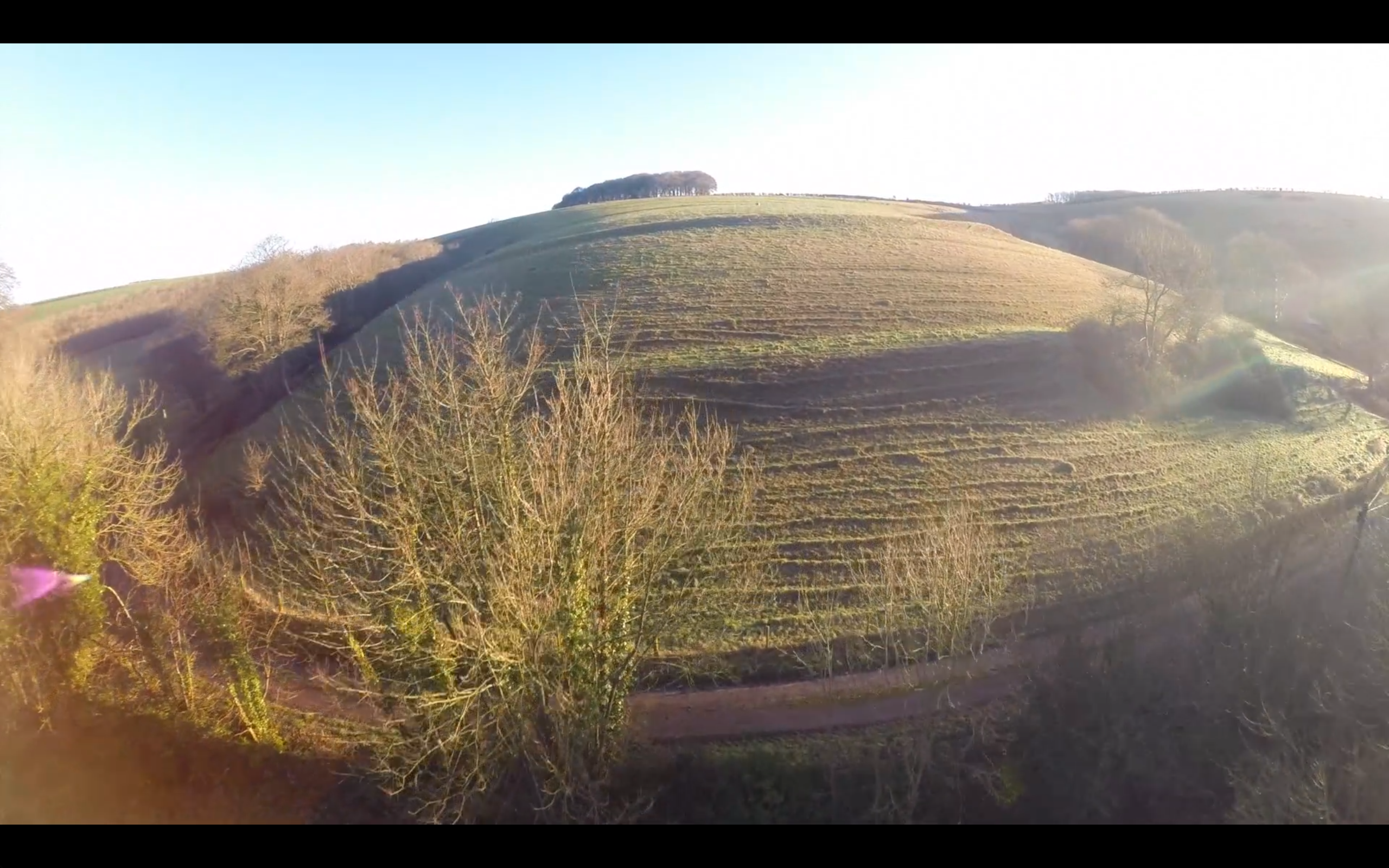

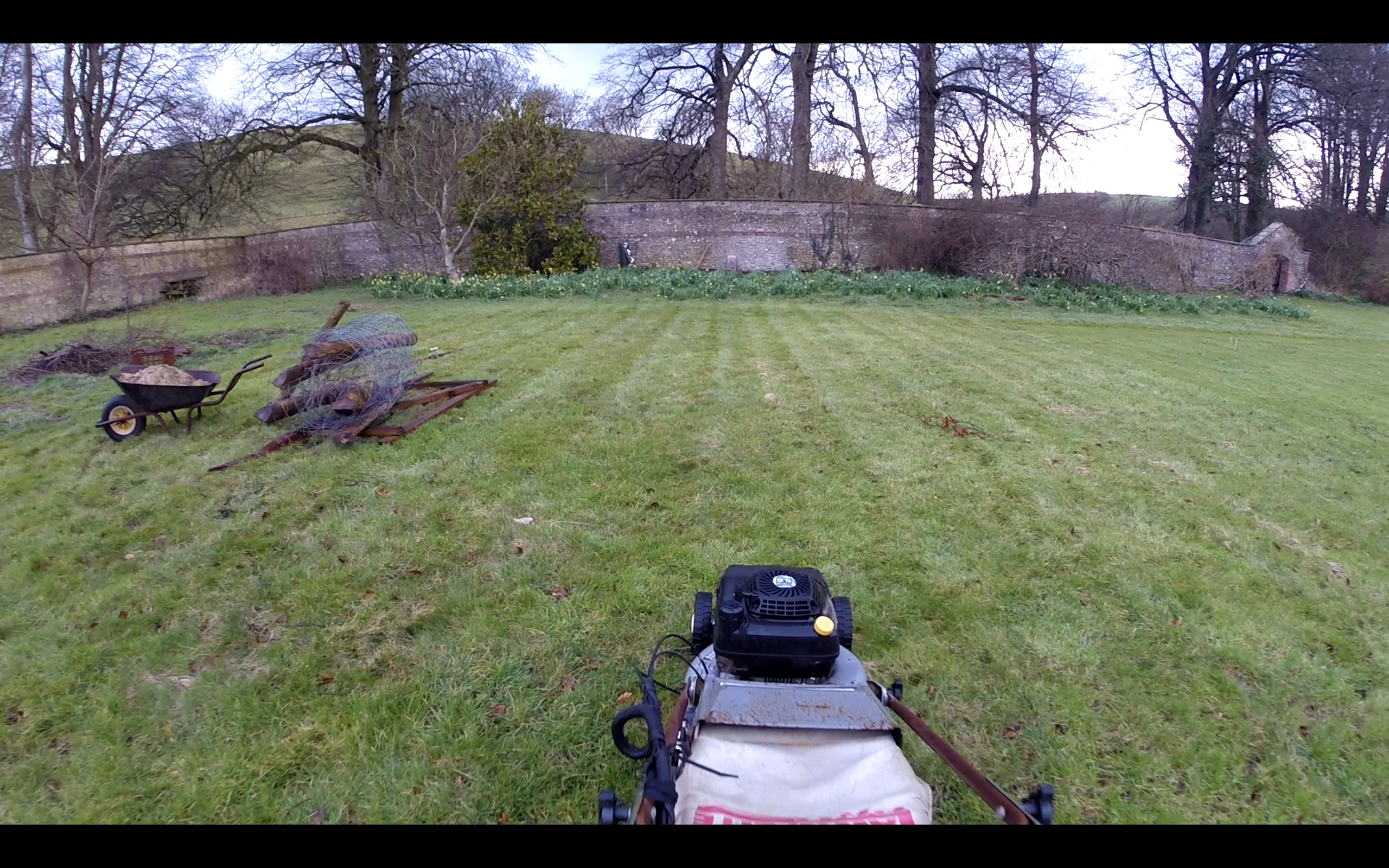

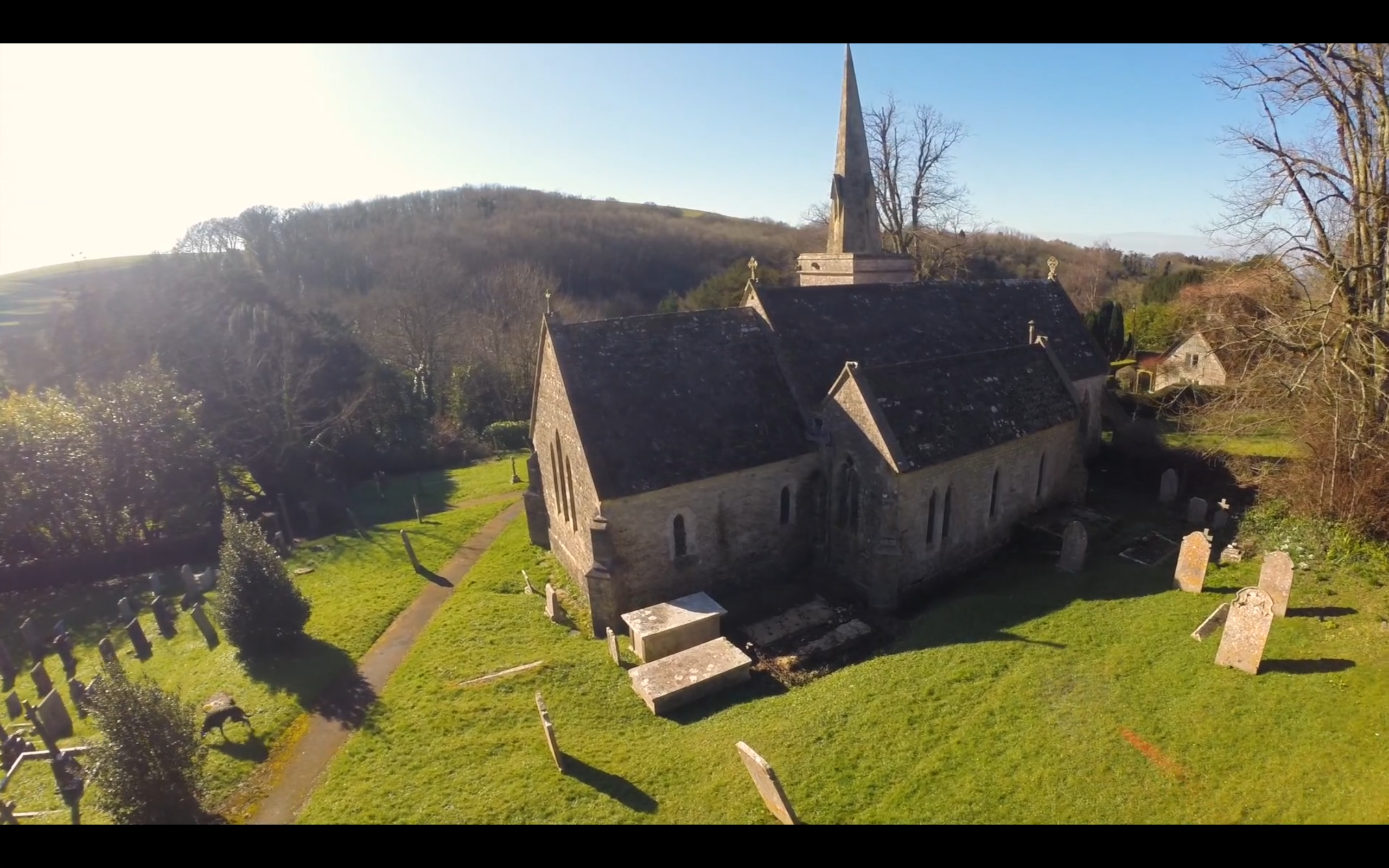

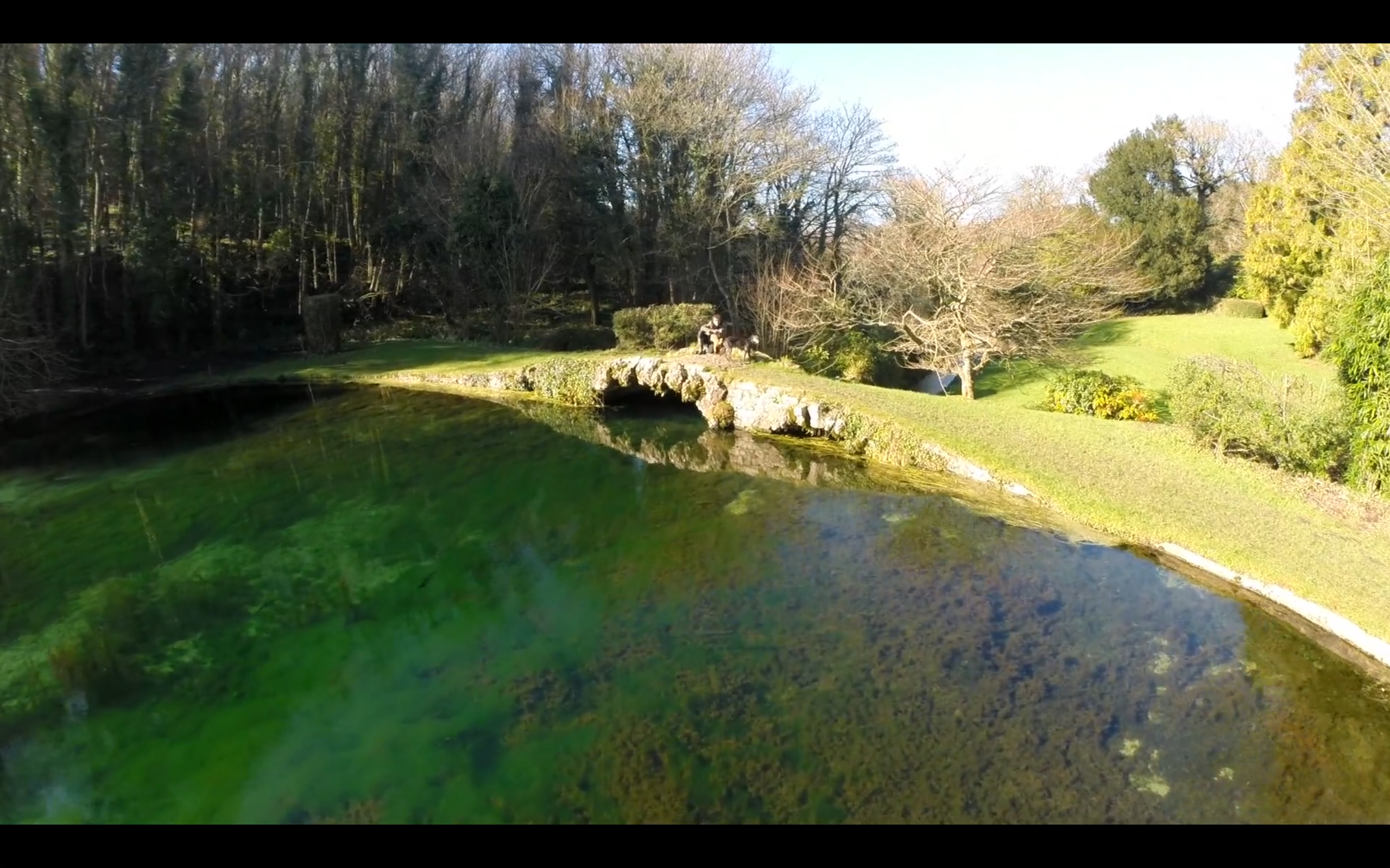

    OK here are some - I'm sure you can tell which are overly white and which are slightly red. The red ones aren't particularly bad in these images, I've had worse, but they give the idea. Screen Shot 2016-03-28 at 21.50.14.png Screen Shot 2016-03-28 at 21.53.04.png Screen Shot 2016-03-28 at 21.54.07.png Screen Shot 2016-03-28 at 21.54.20.png Screen Shot 2016-03-28 at 21.55.03.png Screen Shot 2016-03-28 at 21.55.26.png Screen Shot 2016-03-28 at 21.55.36.png
  7. jason
    Oct 12, 2014
    4,730
    480
    Commerce Twp,MI
    What do you expect from the camera with a fixed f-stop of 2.8 in auto mode without protune turned on. So turn the protune on set it 5500 K and the ISO to 400 and use an ND filter or quit shooting into the sun or pay the price over exposed skyline. Those are your choices.
  8. lonjsnyder
    Jul 25, 2015
    103
    30
    Also note that the GoPro Hero 3 has a terrible auto white balance (has an overly orange tint) and was fixed in the Hero 4.
