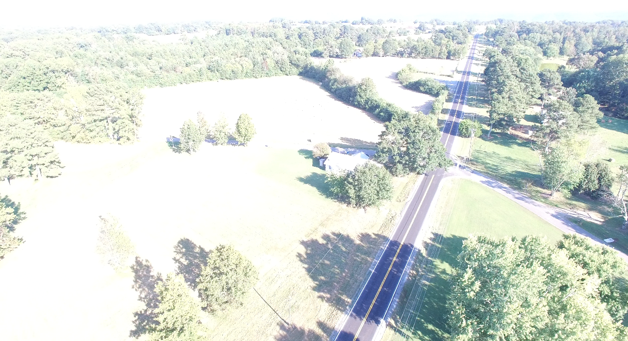

    Normally I don't have an issue but normally I fly later in the evening.
    Today I flew about 2pm and the glare was horrendous on the recorded videos and stills.
    Whats the best way to control or stop this?

    Are you using an NDS filter?

    You need to put an NDS filter on it -- it basically gives the camera sunglasses, you can also dial down the exposure-- this definitely looks over exposed. Do a search on the forum and read up on ND Filters and Camera settings. With an ND filter and on AE ( Autoexposure) this probably would have be a good picture.

    You can adjust that with the roller on the right side of the TX.

    Yes, go into the camera settings and set the camera on the P setting witch will enable the AE icon on the top right of the screen. You can then touch that icon to enable AE. You should spend some time studying the camera settings and see what they do. There is a wealth of information on these settings, on this forum and on Youtube. You wont learn it in an hour, it takes some study and practicing what you learn.

    I believe counter clockwise will darken it, I keep forgetting which way. You can try it on the bench, turn it on and rotate the wheel slowly each way, you will see the picture get lighter or darker. You can also do this when the quad is flying.

    I always try to eliminate most of the sky in bright conditions, like cresballs left example. Also, in auto expose mode I simply touch my iPad screen during flight in the area I want correct exposure and it auto adjusts. Just touch the screen live image, you'll see a square box indicating the area of the live image that it's using to calculate exposure.

    If you rotate the wheel on the right side of the TX counter clockwise it will darken the video And clockwise will lighten it. Hover the phantom and try 1 click at a time you will see what it does.
    When you turn the phantom off it goes back to default so you don't have to worry.
