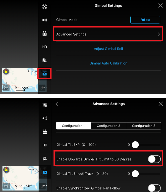

    This just started happening. My gimbal will tilt only to the level position. Sometimes not even that far. I can't seem to locate the gimbal calibration in the GO App? Where is it located? Any other suggestions would be appreciated.

    Try calibrating the remote controller -- like this:
    If that does not fix the problem, then check that you have the following setting enabled in DJI GO:

    Go to your gimbal settings in DJI Go App and select Advanced Settings:
    [​IMG]
    Then select 'Enable Upward Gimbal tilt Limit to 30 Degree'
    [​IMG]

    Ah Ha.....thanks. It was the setting for 30º tilt
