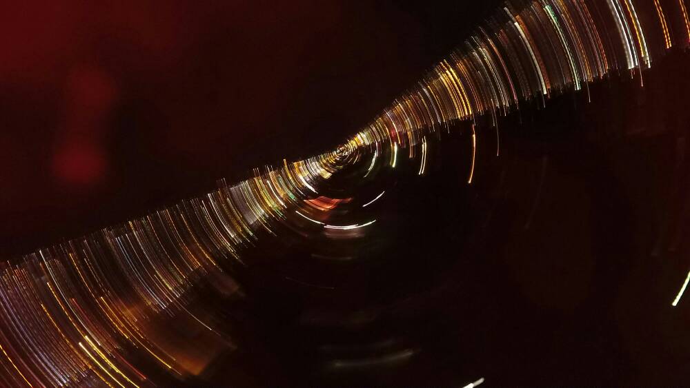

No crash and it just started two days ago in the middle of a flight. I Noticed this pic, so then I brought it down to see what the deal was and saw it wigging out.

So in case anyone is wondering the solution in this case.
I must have taken off from a dusty spot and got debri in the gimbal/camera area according to YouTube videos.
I Sprayed all moving parts with a compressed air can for electronics and everything is working good again.
Thanx for all everyone, much appreciated.
