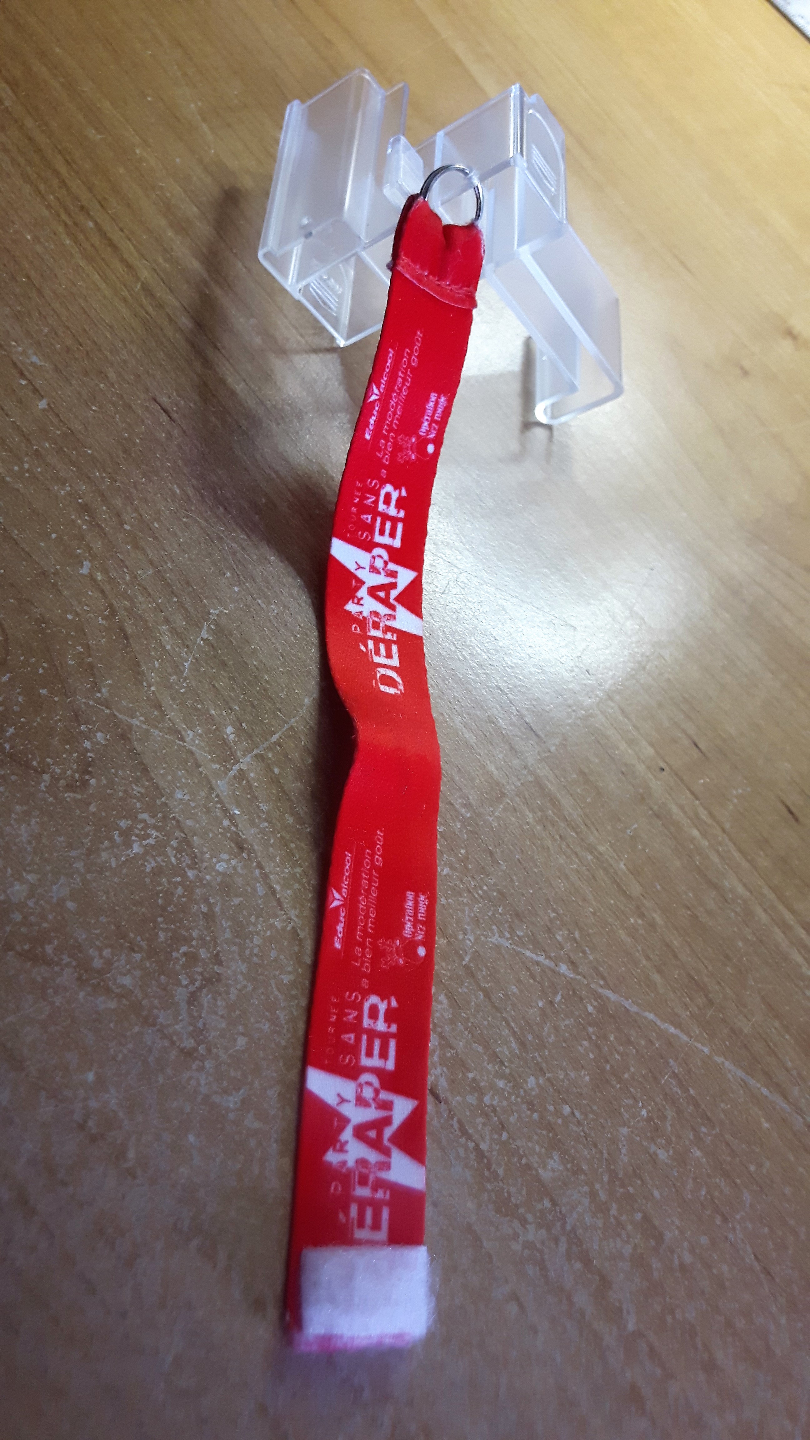

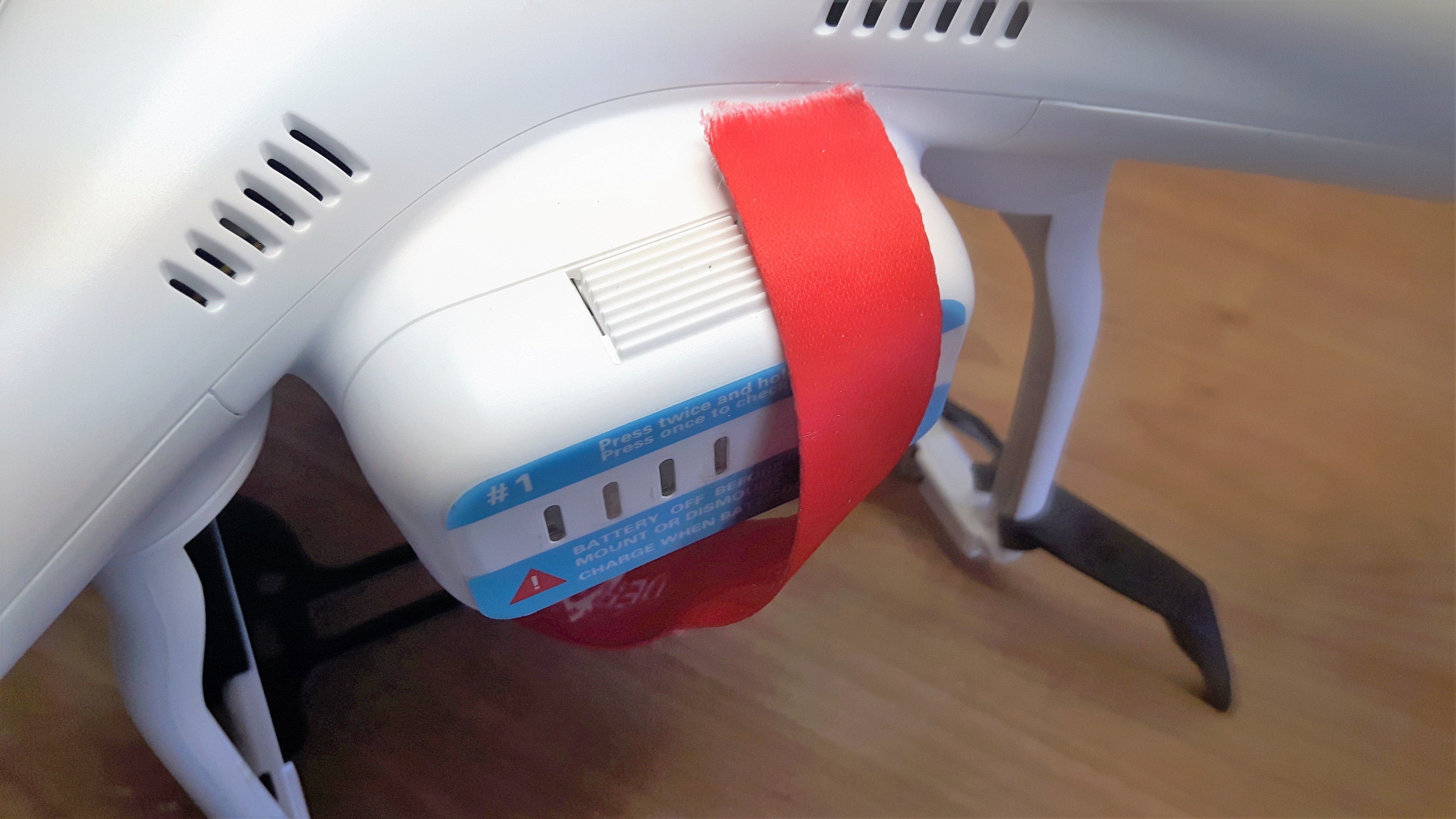

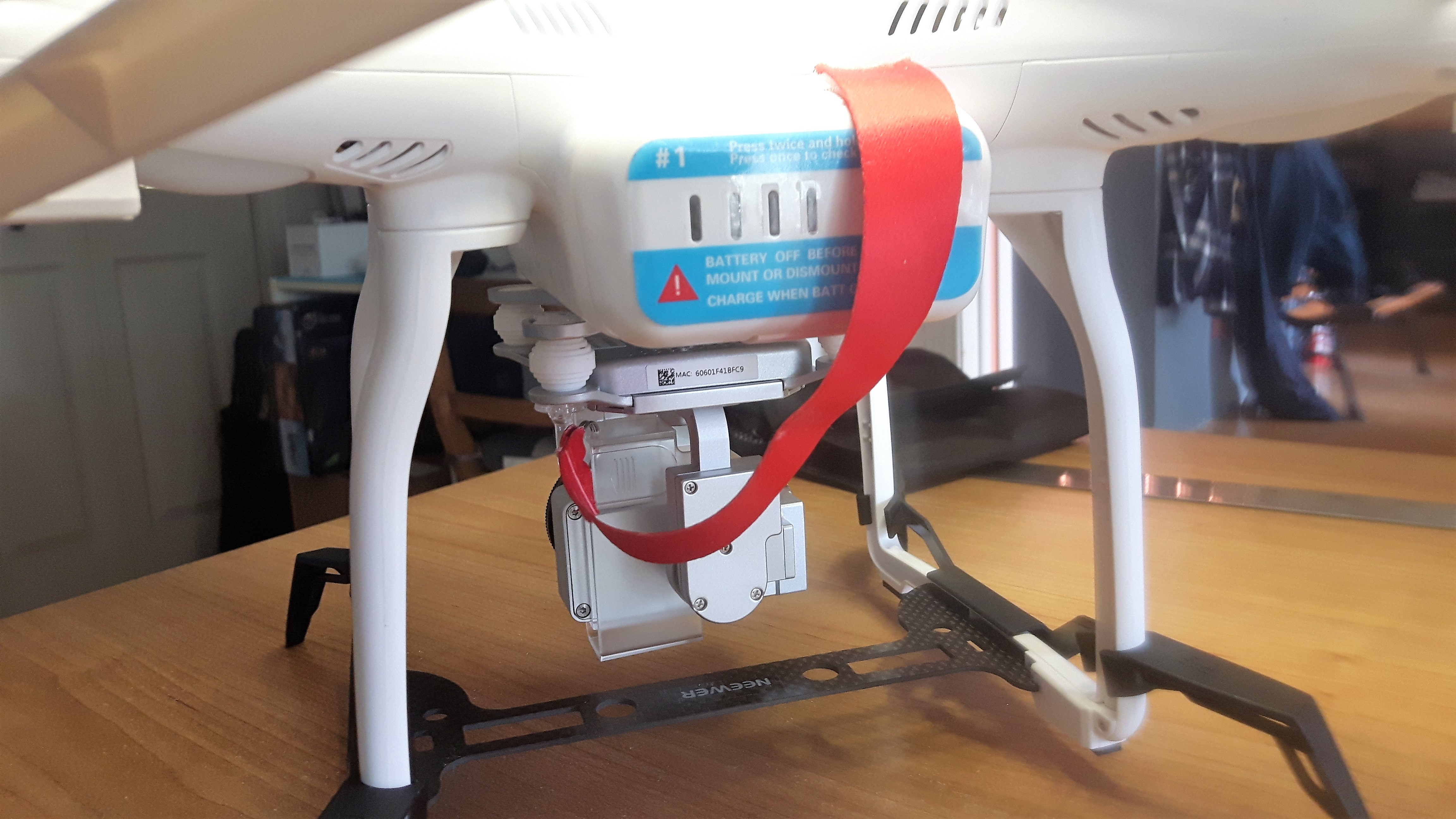

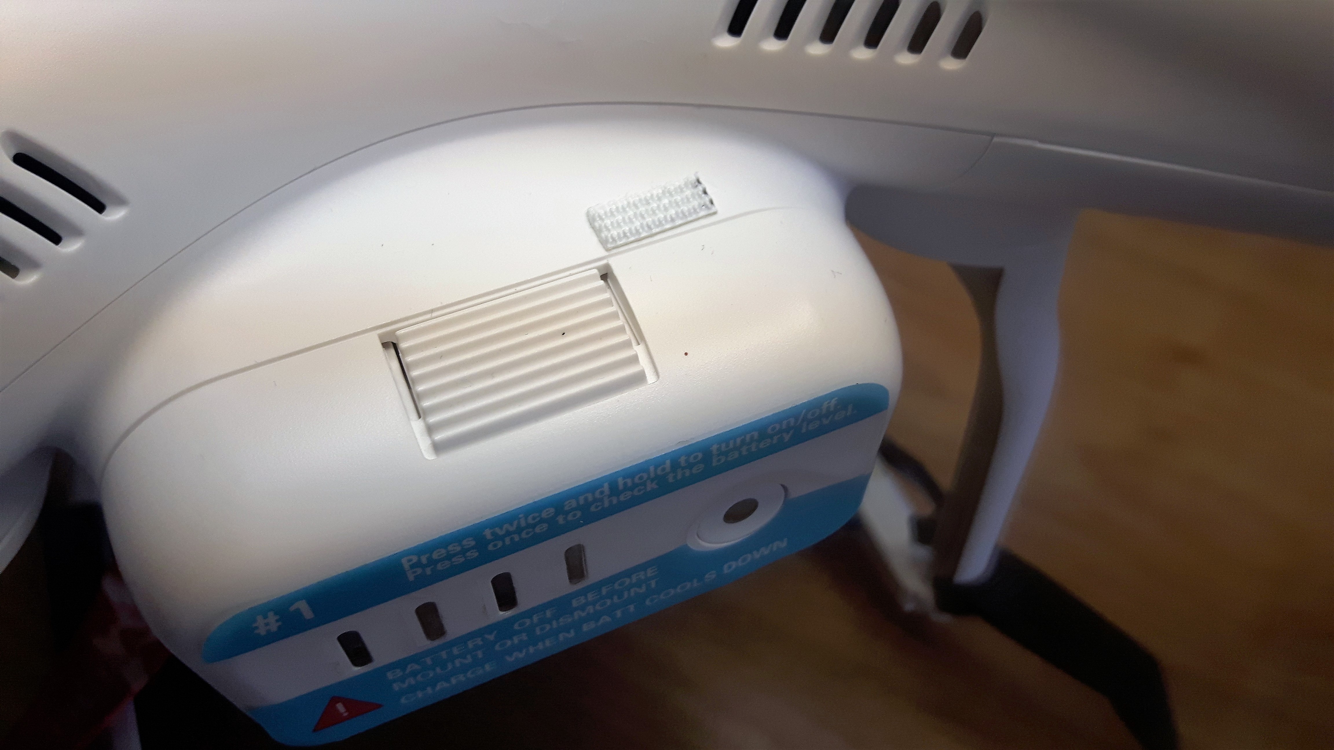

You power up your aircraft to realize the gimbal lock is still in place...either you rush to power it off ( bad idea while the aircraft is booting) or you rush to remove the gimbal lock while the gimbal is forcing to calibrate ( even worst idea) And be honnest, we all did it at least once even with the nice red ribbon attached!
Here my simple failsafe gimbal lock reminder.
