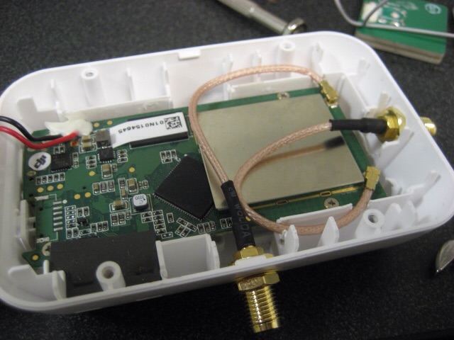

Can you post pictures of the inside of the extender and your controller? We need to see the modifications that were done to each of those .

You should have removed the old cables and antennas while you had the board out. With electronics, you always want clean uncluttered installs.
One of your old connectors is touching the side of the WiFi Module which could possibly cause some leaching and signal loss.
Mike's pics show a great example of a clean install. I'm betting if you follow his pic to get your u.fl connectors seated properly, your problem will be solved.
