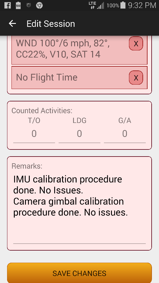

I got footage of the drone slowly panning in flight. I have also had 2 gimble twitches, one which I got on video. I'm really sad now, because all I wanted was a working drone, but I'm not sure if I'll have to return it now... so advice on what to do is much appreciated. Keep in mind I wasn't touching the controls when it was turning.
Calibrate your IMU, and calibrate your gimbal.
Just did mine today
That's not normal. You did a sticks calibration too? Return/replace is what I'd do.
I've experienced this once, but like you said, it was a fairly windy day... I'm not sure if that was the cause but it's good now. I did a stick calibration, that's it
