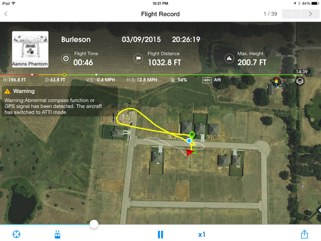

    Howdy,
    So started flying like normal. Landed, inserted 2nd battery, took off and away it went. Northwest like it was in atti mode. I reviewed the play back and I wasn't controlling it till I changed to atti mode and brought it back. Got it hovering over me and switched back to normal gps mode and away it went in same direction. Again, switched to atti mode brought it back.....but this time landed it....lol. It immediately started out with high interference, calibration needed????? So I tried to recalibrate, but it just flat out wouldn't and flashed the lights red on the phantom. Anyone come across this before? I only fly here in the same spot and have 50 or so flights. Never any issues. Any clues?

    IMU calibration won't fix anything. If the IMU was stuffed, ATTI wouldn't have saved it. It was either compass or GPS related as those are the two things that turn off in ATTI mode.
    OP, when you say "high interference" exactly what did it say? Do you have your VPS turned off?

    Yeah, was really weird. Brought it inside, took the blades off and checked IMU and was fine, but did the recalibrate to to be sure. Then I did a compass calibration and all was fine. Haven't tried to fly again, lost daylight, but will try again tomorrow after work. Had the DBS installed and been playing with distances. Had perfect signal and video...lol just started returning to China...lol

    VPS is the optical flow system on the bottom which still doesn't work right. It has been implicated in similar types of events. You should make sure it is turned off.

    Where is the option to turn it off and what exactly is its purpose. 1st time after many flights to have this issue. Seems like a compass issue, but can't figure out where the electro signals were coming from to disturb it. I have power lines around the neighborhood, but have flown close by with never any issues
