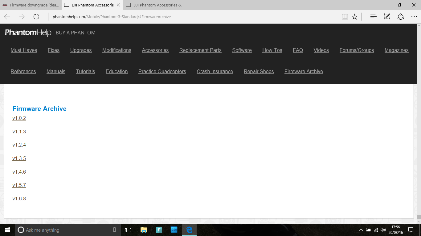

  8. Neon Euc
    Aug 15, 2016
    3,060
    1,273
  9. Neon Euc
    Aug 15, 2016
    3,060
    1,273
