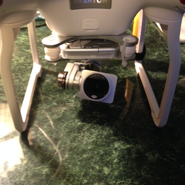

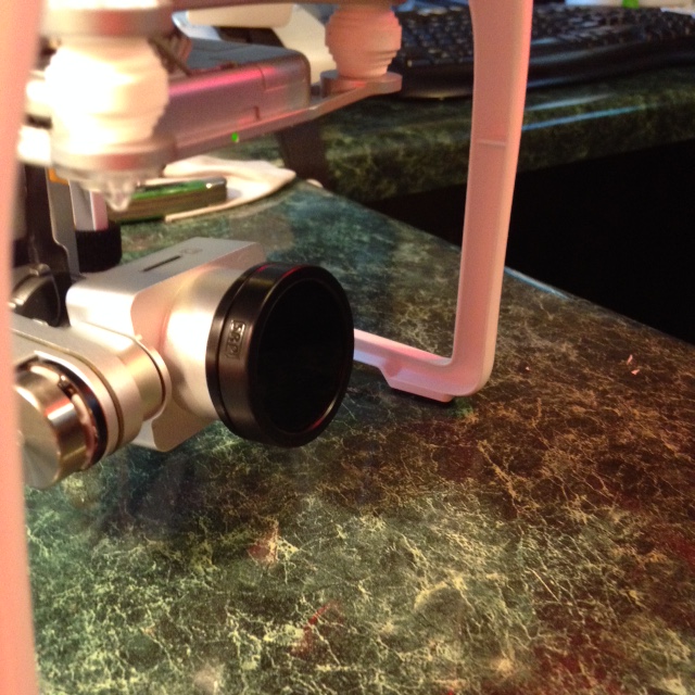

    Here's before filter Proper place.JPG After filter is on filter 2.JPG and powered up it goes right camera filter on.JPG

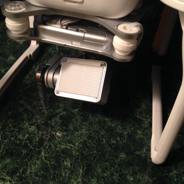

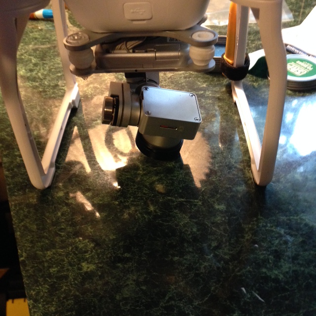

    Now I have added vecro on back to place weight velcro on back.JPG and also gonna have to add a little to the side ....
    I did try calibrating it but ya see what I got .

    OK.....Added10.5 grams to the back of camera and 5.8 grams to the side of gimbal arm and that took care of what you saw in the video .
    You talking adding with the filter 0.84 of a ounce . Is a nice filter but did find it a little hard to slide on and take off .
    Is new so that might get easier . Is great in the sun but not so hot when cloudy . Am just going to use the Velcro so I can add the weight's
    when using it .
    That's what I found with this . Is pricy but ya get what you pay for .
