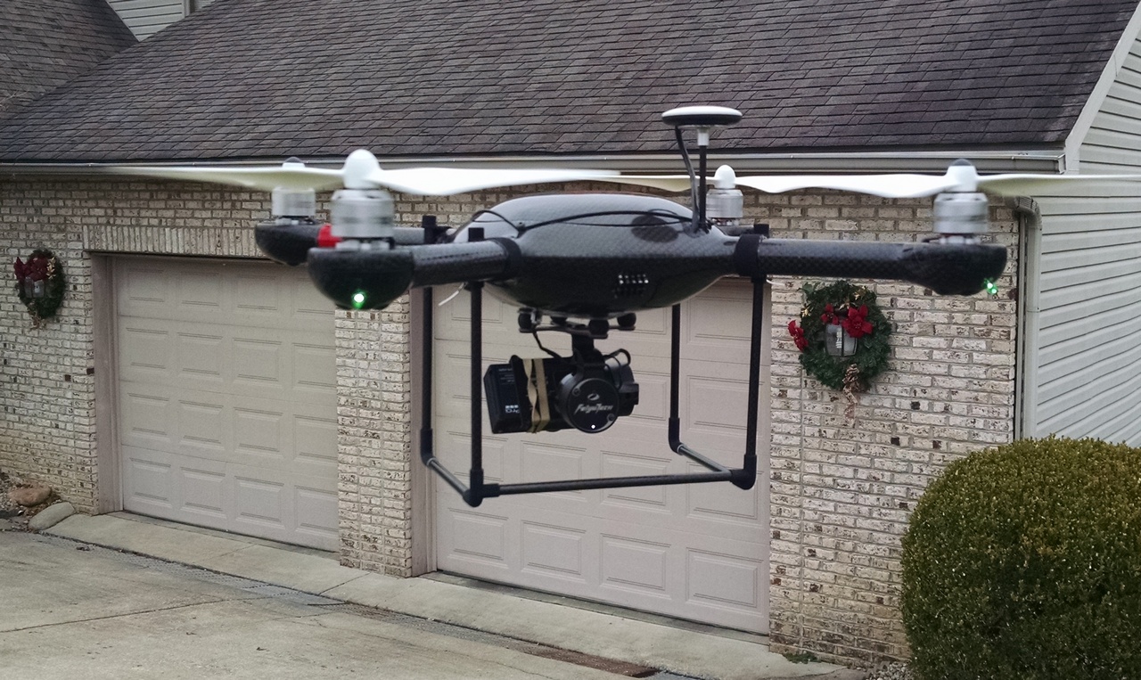

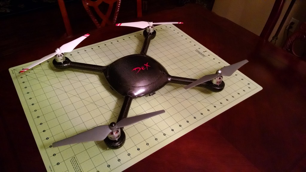

Wow that's badass!! What kind of insides are compatible? Will they take P4s yet? And was it a kit to install the innards or was it all up to you? Never seen that before.My solution: Phantom parts in a Dex shell. It's waterproof and it floats.
View attachment 51677 View attachment 51678
Brushless motors are not bothered by water. Salt water might rust the bearings in time but you can rinse them with fresh water and dry them after dunking. The gimbal motors are also not bothered by water. The gimbal electronics are sealed water tight in the back of the motor housings.What is waterproof about this? The motors appear open, so, aside from shorting them out, it would seem to allow water to flow into the case. The gimble also appears at risk. Have you actually got this thing wet?

The shell is completely watertight. There are heat sinks to cool the ESC's and Gortex vents to let the barometer breathe. I have landed and taken off from water many times but the real purpose of this design is to save the quad in case of a water crash. I have had one flyaway which ended in a water crash. All survived intact. I have a plastic bag which can seal up the GoPro well enough to survive a dunking. I am working on a gimbal for the GoPro in its housing.

Can't answer for the P3 gimbal. The motors should be OK but the other electronics are probably exposed and would not do well. The gimbal in my photo was a Feiyu-tech 2-axis which was easy to seal up water tight. I have since switched to a 3-axis gimbal.This is most interesting. Thanks. Are you quite sure about the stock P3 gimbals being watertight? They don't look it on casual inspection. I'll pass on the hammer business, but water resistance is definately a plus. The problem being that even if the bird survives, the camera is all drippy wet and you won't get good images. Perhaps Rainex on the filter.....
