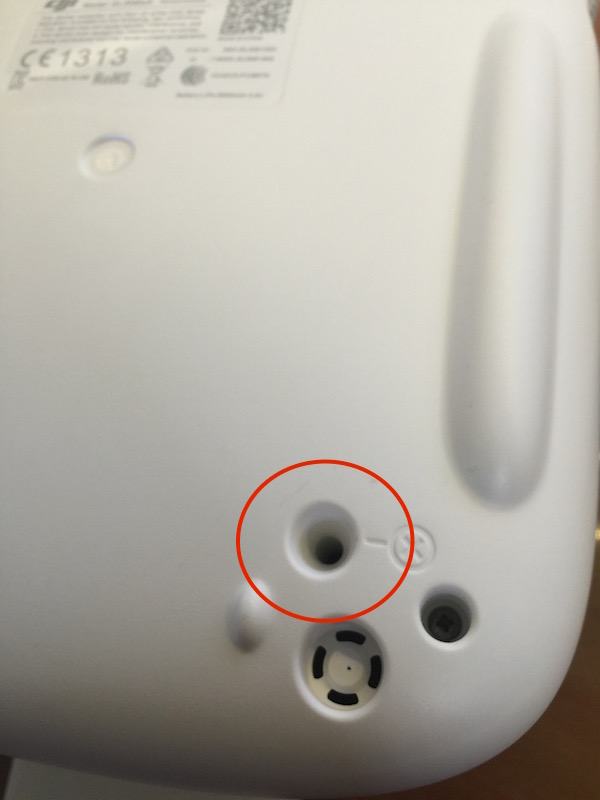

I didn't know that. Thanks sir for that tidbit of knowledge.You used to be able to change it via an opening in the back of the TX.
Right through that hole.I didn't know that. Thanks sir for that tidbit of knowledge.
Is it documented somewhere?That setting is automatically set based on your Phantom's current GPS location.
I would not of thought that fcc or ce certification would be based on gps software.That setting is automatically set based on your Phantom's current GPS location.
Not that I could find. DJI mentions it sometimes though -- like in this thread.Is it documented somewhere?
Oddly enough, the P3 Standard uses the same shell as the P2 controllers so the hole is still there but the switch pot under it is no longer there.
