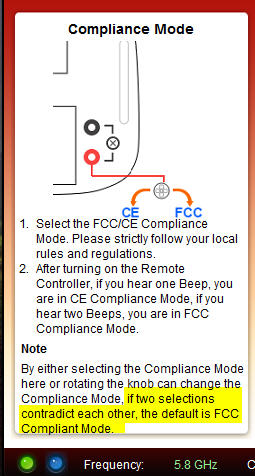

    Boy, you guys don't really read the instruction on the software eh?
    Screen shot taken directly from RC Assistant software. Please see highlighted part.

  17. yawnalot29
    Apr 2, 2014
    676
    123
    Bottom Line:
    If you want to be able to toggle between FCC & CE mode via screw on your controller. Set the firmware (via RC Assistant) to CE mode. Then when you turn your hardware screw to CE mode, the 2 settings match and you are in CE mode and if you turn your screw to FCC mode, the two settings contradict and the default is set to FCC.
    However, if you set your firmware (via RC Assistant) to FCC mode, the screw will appear as if having no effect. Because if you turn the screw to FCC mode, both settings match and you are in FCC mode but if you turn the screw to CE mode, the two settings (firmware vs. hardware) contradict and thus defaulting to FCC mode. So the net result is that you always get FCC mode.
  18. Gonefishing51077
    Nov 16, 2014
    115
    Yawalot
    Thank you for your information. I have not seen that screen.
