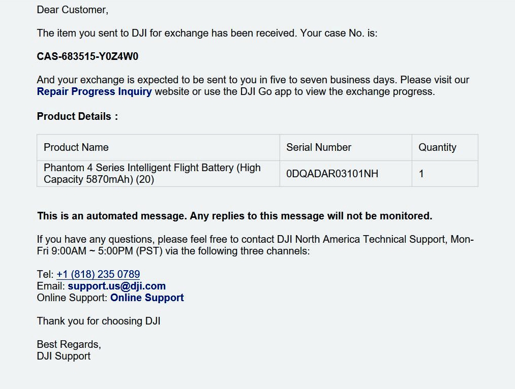

So, DJI sent me a return label, I sent the battery to them. They received it yesterday. I got this email today:
Looks like pretty good customer service to me......................

That's what everyone get, until you notice that they are preparing for shipping your battery and stay there for weeks and you started to wondering what is going on... :)

Replacement battery is on it's way........ I have had only 2 occasions to deal with DJI on warranty issues and both went as smooth as anyone could ever expect.
Kudos to them!!
