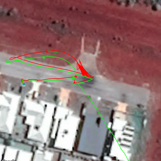

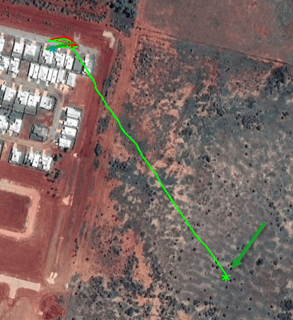

@sircking sorry I got delayed in getting back to this. After the P3A started misbehaving were you able to land it close to the launch point or did it land SE of the launch point. The .txt that you provided has the path shown in red.
The green path is computed by integrating the North and East speeds.

It is just what I asked for ... and as I said, there was no charge for it
Your flight data shows that something odd is going on with the GPS.
I've not seen anything like it before and can't think what might cause it.
It's showing 11 sats for most of the flight, which is an appropriate number for a P3 Standard.
It's recording a home point and the flight track shows that it's getting GPS position data throughout the flight.
But the GPS health shows as 0/5 for the whole flight.
*update* This is incorrect - Airdata showed the wrong information for this parameter
The flight track looks like you had full control.
What do you mean about control was lost?
META4 some good news, I bought a new GPS module and replaced it, also found that the GPS plug lock is broken so it may have been coming loose during flight due to vibration (MAYBE), when I replaced the GPS module I hot glued the plug in place.
Works perfectly now, I flew a whole battery through it on Sunday with no problems. thanks for reading the flight data for me, greatly appreciated, sorry I doubted you.
