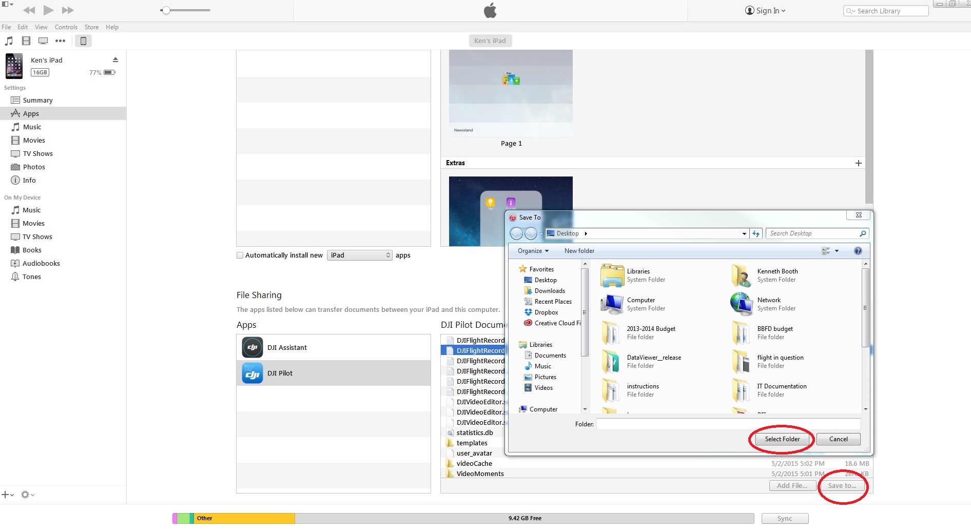

You don't even need a 3rd party app.. You are able to access flight logs and video from iTunes.

I just downloaded all my logs through iTunes, I never even thought of looking to see what else I could download.
Thanks Blade - that'll do nicely :)
